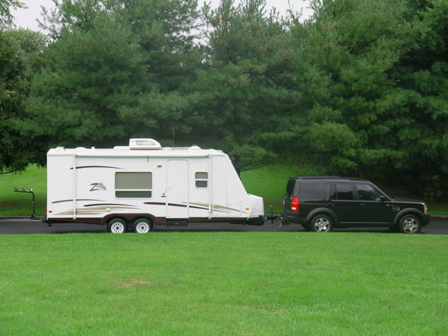

LR3 Hooked Up
Picture that I said I would post last night, tonight.
