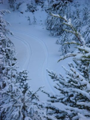

Now whoa up there I was just starting to get ready for my adrenaline adventure down my driveway and hopefully back up it again and already had in my mind what the setup should be which was pretty much at nathan (we have a son named nathan and he's usually right too damn it) and then we get back into the HDC on off on off 1st gear 2nd gear and yet one more time I wussed out. Now we are not only out of milk BUT BEEEEEER. And that gets quite serious. Its too far to walk so ................
Start her up
Put in Grass gravel snow setting
Get into Lo range and then...............
Yes maybe HDC and then.................
1st or 2nd or stay in drive ..................
AAARRRRRRGGGGGGGHHHHHHHHHHHH
Then on the way back up assuming I am not wrapped around a friendly tree or down a gully I was going to just leave it in grass gravel snow and drive in reg Hi range ...................
I sense that migrane coming back and was so ready so ready to publish pics of the LR at the bottom and of course again at the top BUT NOW.................ummm HELP

You guys have gone above and beyond in you help, advice and just plain humor. Thanks so much - the driveway was duly negotiated today without a hitch, scratch or need for changed underwear. This forum is very good and frankly I feel so much better being able to ask what might appear stupid questions but who else to turn too............

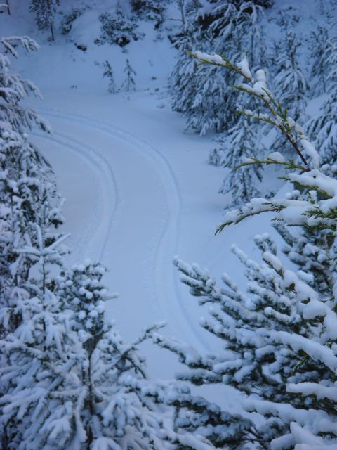

thanks bob. it was "cool" this morning- high 30s.
one of the perks of living down here is that when we want snow, it is only an hour or two away. here's a shot from last winter:
take care and be safe.
