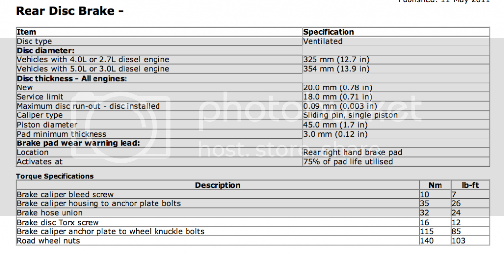

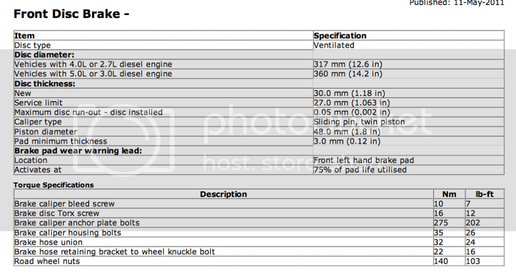

Where is the easiest location to find all the torque specs for the entire vehicle? I think I have a rear shock bolt loose.
mbw
Aug 8, 2010
1,700
442
Des Moines, IA
yes. 203 ft lbs.
umbertob
Apr 18, 2006
2,701
433
California, USA
Torque specs rear suspensions.
  • Torque Specs LR4 Rear Suspensions.pdf

I am really surprised at that torque setting...twice the lugs! amazed it is that high, used to seeing 80-100 for those.
