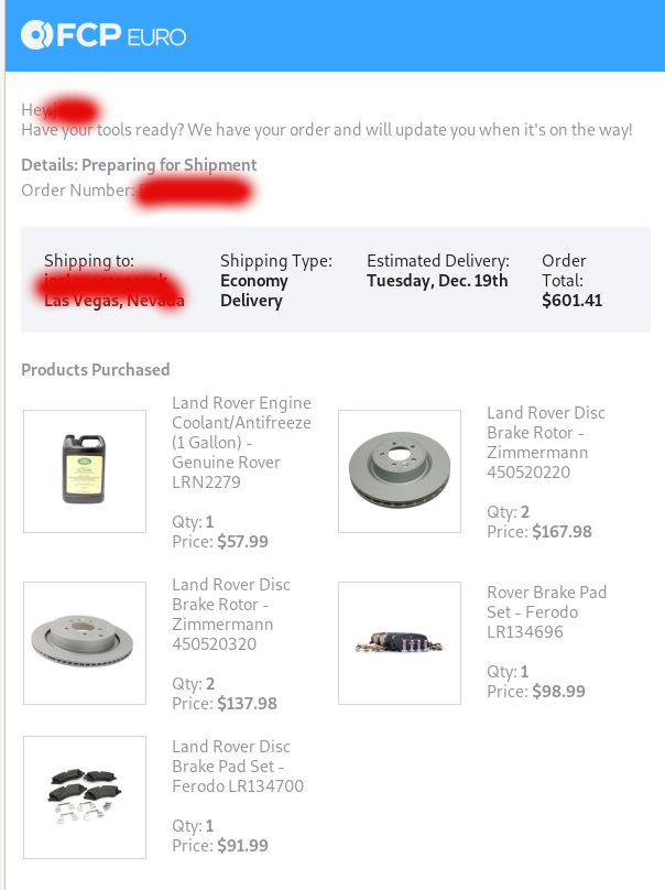

I save a few hundred by avoiding the dealer and still bought quality parts from FCP Euro. I bought front rotors too and still saved hundreds. I appreciate all the help. The Zimmermann rotors are not made in China, they are made in Germany and are high carbon steel with rust preventative coating. The pads I think might be OEM compound and the compound didn't have any description at all but the brand is good.

I've always used a classic C-Clamp and an old brake pad to compress the caliper. Maybe the special tool makes the procedure a little less clumsy and a bit more elegant? No idea. But I'd only be interested in that special tool if I was doing this job for a living; not doing it once every few years like I do.
The Ferodo brake pads are the OEM pads.
