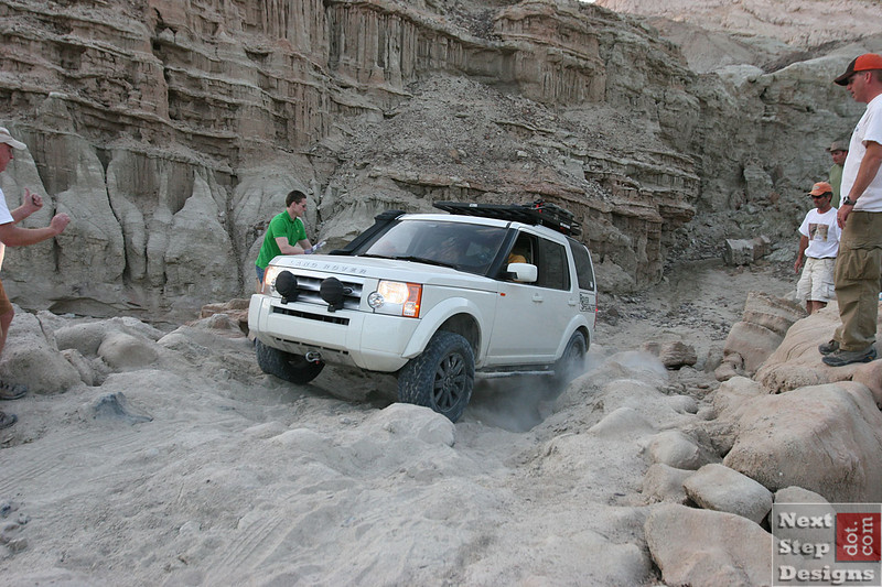

Ironically I don't have much of anything for mods, I just kept it pretty stock other than a few things
Rebadged with the Discovery 3 logo
GoodYear Wrangler ST 265-60-18
In the future, probably an A-Frame or another front facing bar with lightkit, and perhaps some skidplates... I like to keep it simple :)
