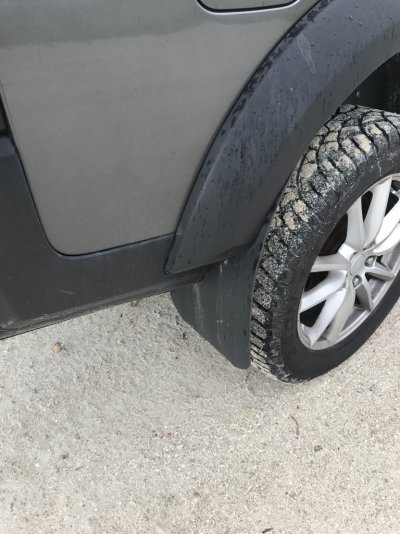

I have OEM rear mud flaps, and they do catch a lot of mud but not sure about rocks. I would assume they will help a little, but they don't hang down a huge amount.

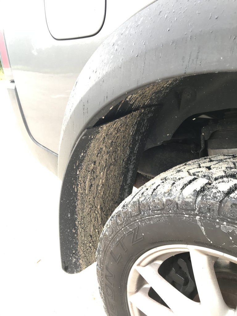

You need the OEM rears for sure. The first time we drove on the sharp cracked gravel used here on rural roads towing our Cricket trailer behind, we were horrified to hear and see gravel hitting the trailer and bouncing back off the rear glass. We bought the OEM fronts as well to prevent gravel from piling onto the running boards. This was with the stock Conti’s.

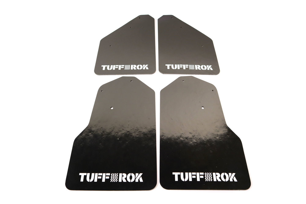

I have been running Tuff-Rok for several years and they have worked out great.

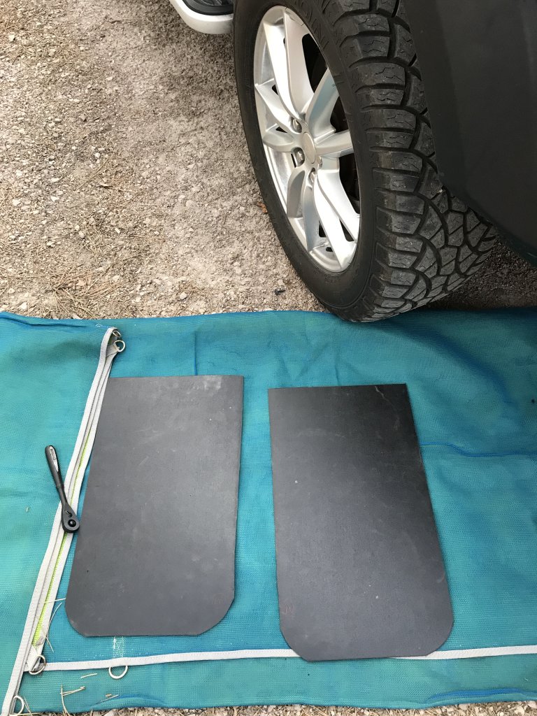

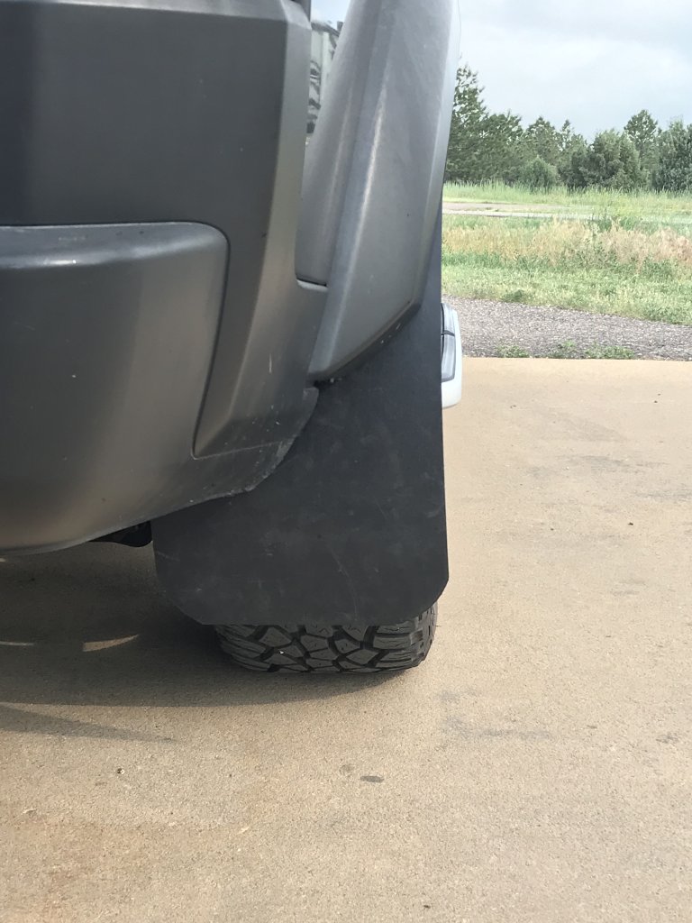

Hi I tow an Airstream with Coopers and love to go to national parks but will cringe going on the pebbles and gravel roads. Stopping at Love's gas station it occur to me that I could buy one tractor trailer mud flap $15 , Black fender screws at auto part and cut 4 flaps out of it extra long for the back. No more nicks ! now traded to a 2022 Bambi still impeccable 90 days later.

Curious to know how stiff are those mud flaps? I wanted to do this, but the ones I've found were not flexible enough for me to climb over things without it ripping it off or causing other damage.
chrisp
Aug 25, 2015
36
Nice hack :) Did you have to drill new holes to mount these? I'm running the exact same tires. Cooper LTZ
TacticalBeliever
May 28, 2021
USA
Good blend of stiffness won't lift at highway speeds but curves easily on obstructure. even use them as curb feelers on driveways :)
