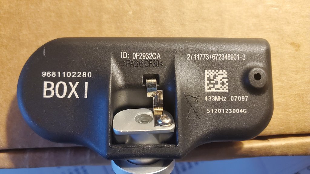

Thanks for the feedback. I opted for the BOXI units I saw on Amazon. Part # LR070840. About $124 for 4 sensors. My garage said they'd swap out the sensors and mount on my LR4 for $25-$30 for each wheel depending on how hard it is to remove the old sensor. Fingers crossed for full compatibility. We are getting our first dusting of snow forecast for this Friday.

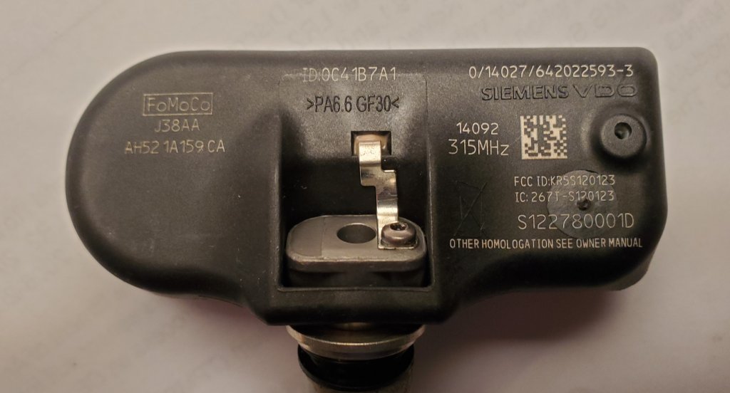

FYI - Replacement of 315mhz TPMS (were on wheels I recently purchased for snow tires from a 2014 LR4) with 433mhz TPMS. Bought BOXI / LR070840 for my 2016 LR4 HSE. The form factor looks identical so I don't need to rebalance the wheels.
My local Shell station's Autel MaxiSYS could not see the BOXI sensors so I went to local independent tire specialist who used a Bartec and they said they woke up fine after a little time and showed 0 psi before being fitted to the wheels. Tomorrow I am mounting the wheels on the car and hopefully they will Relearn and pair to the car. Fingers crossed. BTW, i called my Land Rover dealer parts department to verify the part number and they quoted me $200 per sensor. Seriously?
