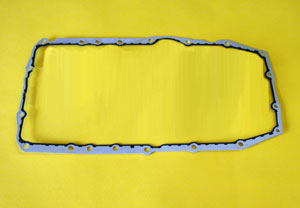

Here's a pic of the gasket. It's not the transmission gasket, it's the one that runs the perimeter of the oil pan. It looks like it should be easy to drop the oil pan except for the rear of the pan. I can't tell where the oil pan stops and the tranny pan begins.

I've changed mine twice, and each time had leaks. Hardly leaked at all before.
I'm not sure if it's as easy on a D1 as a DII, but there's like 42 little bolts that hold the pan in place; then you just drop it down and scrape all the old gasket bits off.
Drain your oil first, of course :biggrin:
