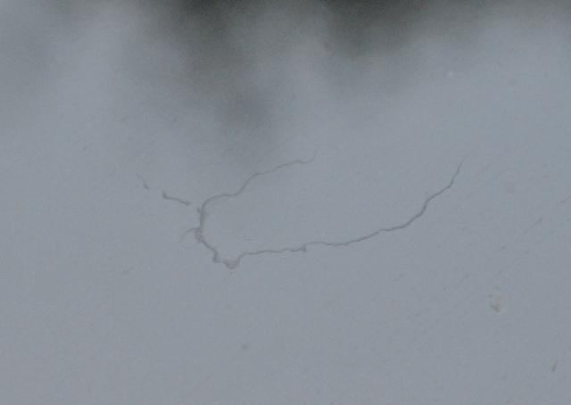

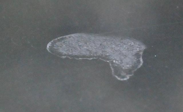

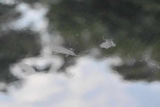

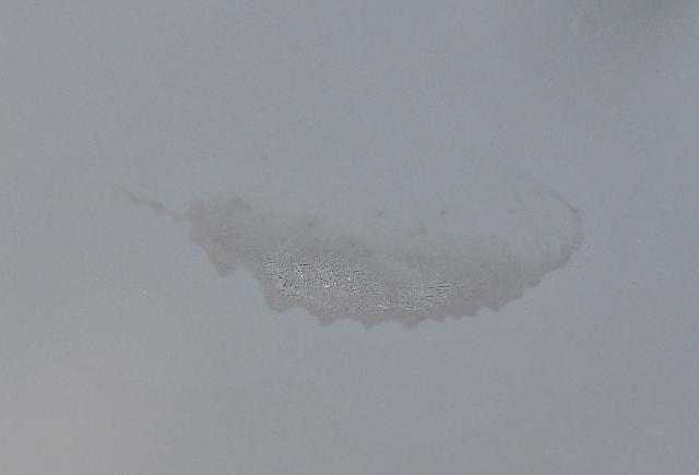

Please help - what is going on with my paint on my hood? I thought it was bug/tar but these photos with a macro lens look like a bit more. It's 4 months old.

Maybe acid rain? Get the dealer to look at it. Maybe you can convince them to take care of it under warranty.

That looks like a combination of water spots baked on (like it sat in the sun), and/or some sort of surface contaminant (like tree sap, acid rain, etc.). It is something that a clay bar should be able to handle pretty easily (but it likely won't wash off with just a simple car wash - even hand washing). I swear by Zaino - I've never used their clay bar, but if it is as good as their polishes, it will work wonders:

I have some funk like your white spots that on my hood - will not come off with clay bar or anything... my guess it is probably some bird crap that was left on the paint too long by the prior owner and damaged the clear coat. Ticks me off.
But I think richpike is right, some of your marks do look more like water spots and should come out...

I also use Zaino products and have used their clay bar. I can't imagine something like that not coming off with a clay bar. The clay bar, when used correctly, seems to take off just about any kind of marring.

Thanks so much for the feedback. I am going to talk to the dealership before I try anything. I have no experience with the claybar or Zaino products but perhaps I soon will. My concern is that the crystallized look and/or cracked paint look to me implies that it is much deeper than any topical product can fix. I suppose I'll soon find out.

I took my LR3 to the dealer on Saturday for evaluation of the spots on the hood. They felt that it was likely due to some type of tree/sap. They buffed and wet sanded it out and it looks great. It did go down to the paint, through the clear coat. There are a couple of very small spots that did not come out, but it looks great.
I am certainly glad that I waited to get their input first before doing anything myself. Thanks for everyone's input.

Wow - that was some serious tree sap. Glad things turned out OK, but I'd be concerned that it went all the way through the clear coat - definitely keep that area waxed well.
