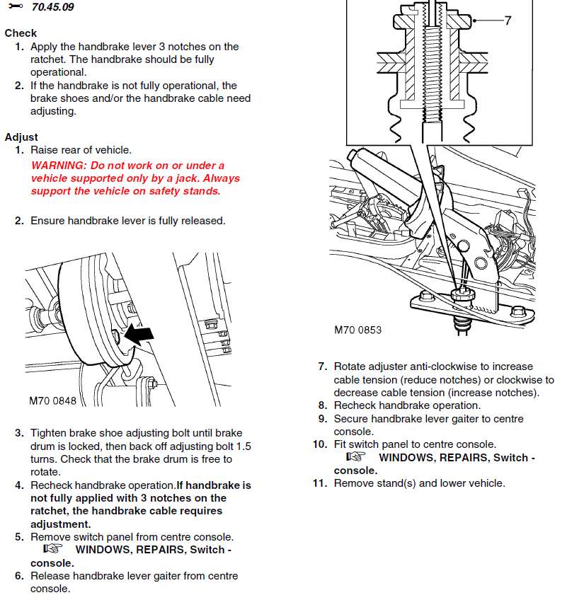

Does anyone have instructions on how to disassemble the console to replace the parking brake lever boot? I'm guessing it is not too difficult, but there are no obvious screws to accomplish this.

Hope this helps

Thank you for this inf, Joey. Can you post the page on removing the switch panel from the console?

Will do tomorrow, unless someone else can do it... I am out of town working tonight and do not have the manual on my Laptop.

Dowload the manual
Go to the thread posted by Joey on help w/codes -this is in a posting about 4 down from this one on the forum site - and follow the link posted by Joey to Landroverresource.com and download the workshop manual. The page you want is page 44 in section 78-Chassis and body

If all you want to do is replace the boot...
On BMWs you need to pull the brake handle off. Its tiring to do, and in the past, I've needed to use heat and silicone spray.
I'm new to LRs but it looks like the same process
Garage Tool
Sep 4, 2009
OK, just checked, remove the brake handle by twisting and pulling, the boot unsnaps like the image above shows

KK, it's a long but not difficult process. The switch facia just pops off (carefully, with a small screw driver) which will reveal the switch assembly. Remove the switch assembly and disconnect the switches, they are color-coded and will only go back on one way.That should give you clearance to install the new EB boot.
If you need to remove the console, remove the rubber pad around the gear shift. You should find 4 screws there, remove them. There should also be 2 screws at the front of the console, remove them also. Now, you should be able to remove the console, but the cigar lighter will still be connected here. Disconnect that. Removing the console will be the most difficult part. I found that I had to disconnect the emergency brake to provide clearance. It's a C-clip and pin. Hope this helps.
