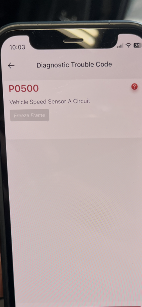

Hello all. Wondering if anyone could be of help here.
I have a 2010 Range Rover HSE that is getting an error code P0500 vehicle speed sensor circuit A.
I found a similar thread on the boards and the person fixed the error by replacing one of the ABS speed sensors on the wheel hub. In his case, it was the right rear.
I live in California, and this error messages is preventing me from passing smog and registering my car.
The shop that's doing the work it is insisting that it's the transmission speed sensor that will require upwards of $2000 plus of Work to switch it out.
I currently gave The go ahead to switch out the right rear ABS sensor to see if code go's away.
They might test and troubleshoot the other 3 as well.
The strange thing is that their diagnostic's show all 4 sensors working properly.
Anyways, I'm trying to see if this will be the fix, before I move onto the costlier work of replacing transmission speed sensor.
So I'm wondering if anyone here, in addition to the other poster with the same problem has any experience/ insights with this?
Also, does anyone know if " A" designates which sensor it might be, or not related to location?
Thanks! so much..cheers!
