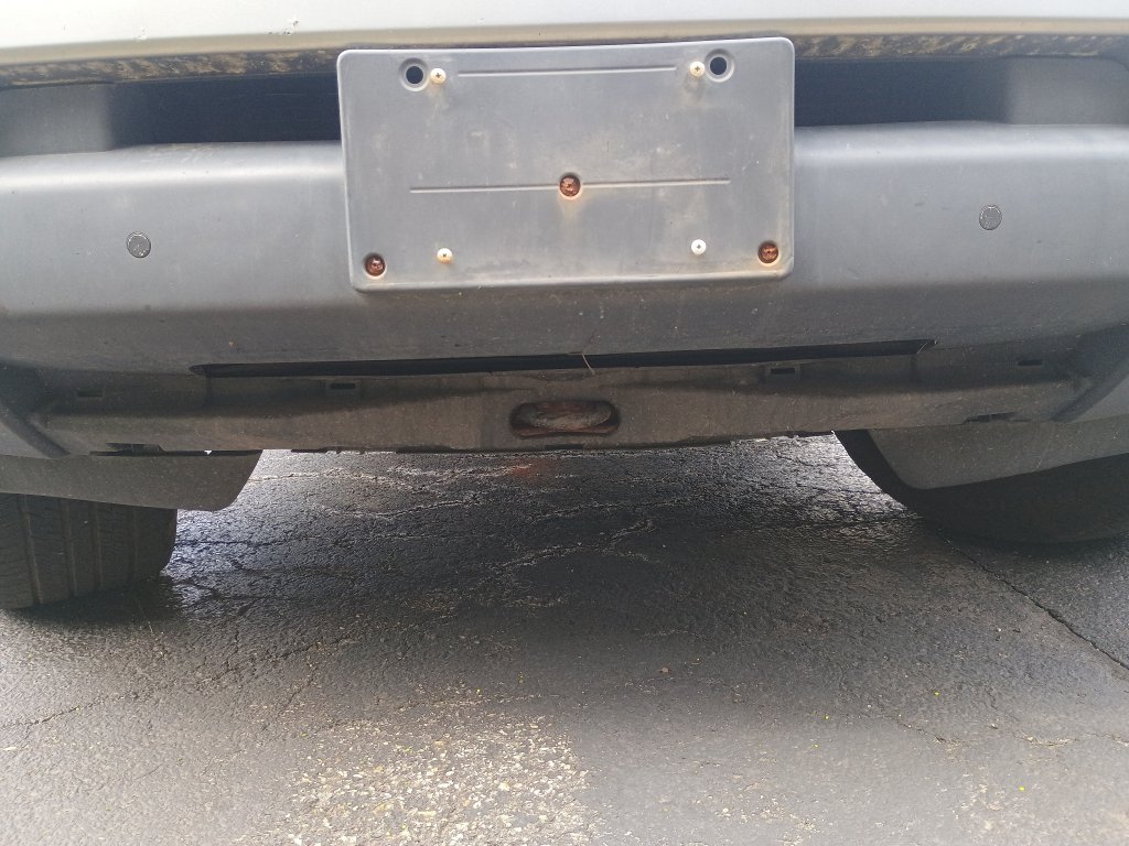

Yeah there's a plastic cover that you can remove to expose the front row eye.
When I look at the front all I see is the plastic bumper and not a plastic cover to remove. There is a black plastic piece in the center of the front bumper that would be near the winch position. Do you mean that piece comes off and there is a tow hook behind it?

The front tow loop, yeah it's under that piece. Pops out just like rear cover, use a quarter to turn screws.
