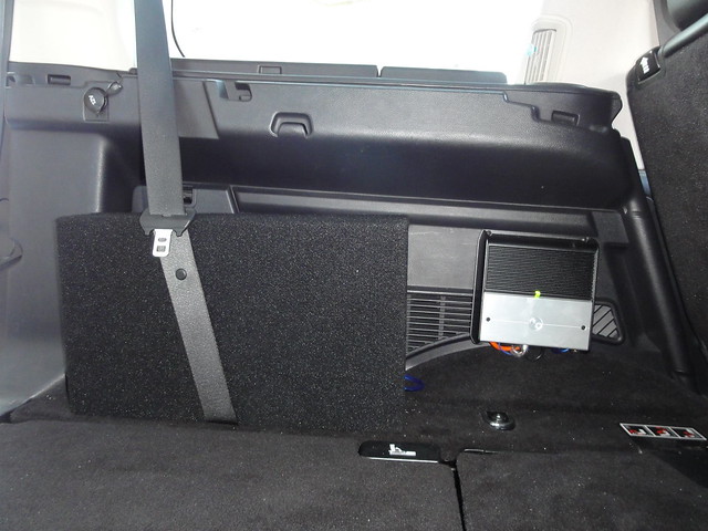

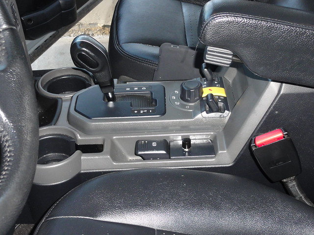

I actually mounted a JL Audio 8W3v3 in my LR3 and used a JL 250x1 amp for it. Also used a line converter and tapped into the sub output from the factory amp. Wired it all to a nice control knob that mounted behind my parking brake and it actually hits harder than I ever imagined.
My friend initially mounted the Pioneer Shallow mount in his stock location and it did take a little bit of cutting of the factory mount. It was a fairly cheap sub and he ended replacing it with a Rockford one that hit pretty hard, unfortunately it also rattled the tailgate outside no matter how much dynamat he put in there. This is why i went the way i did. It is enough bass to feel it and render my mirrors useless but sound great when listening to different types of music. Also being able to turn it down with a quick turn of the knob makes it nice to adjust the bass on the fly and when the kids are with me without having to go thru the audio settings in the stereo itself
