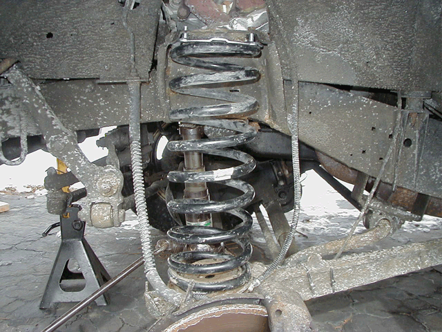

I skimmed the link you had up, seems like it would work...although I haven't really read it. JKS disconnects (if you can find them) or something like those would probably work best for you if you really don't have a lot of customizing skill...on vehicles like cherokees for instance you can just unbolt the ends of the swaybars, tie them up and then reconnect them at the end of wheeling (takes just a few minutes) Unfortunately Rovers are not quite as friendly in that department and are more difficult to take off and reattach...some people just run without them, but I wouldn't advise this because I don't want to ever see anyone get hurt because of a poor suggestion, but it is done. I will see if I can find a pic to show you location.
ColeCam
Jul 23, 2004
165
Look behind the axle, there is a connecting bar that runs parallel with the axle, this is the sway bar, where it attaches (near the hub) is where one would put quick disconnects. (note: not the control arm which is keeps the axle from going front to back.) The sway bar is right above the control arm, then bends and runs across the vehicle, it has a mount connected to the frame (also it goes right below the exhaust).
