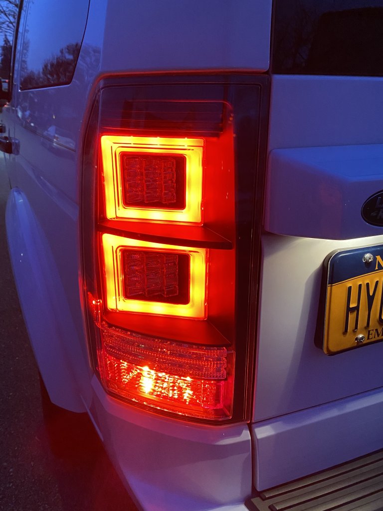

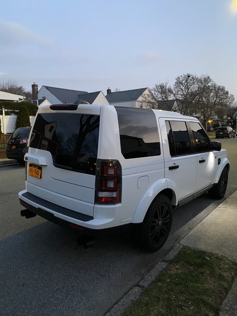

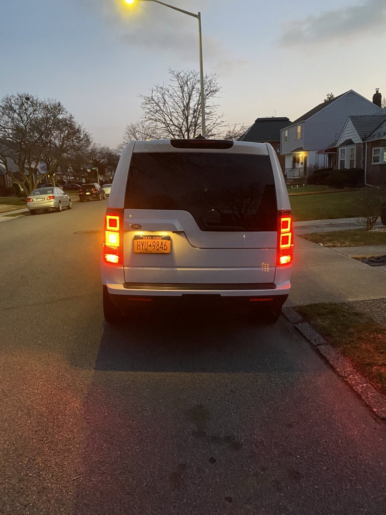

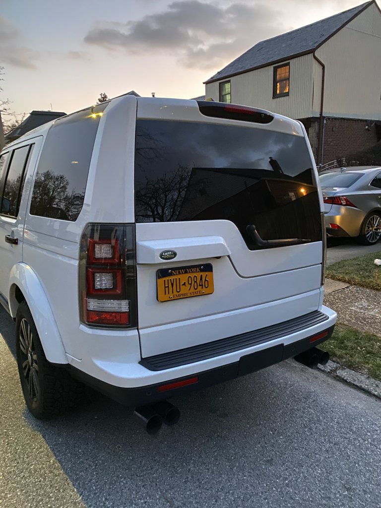

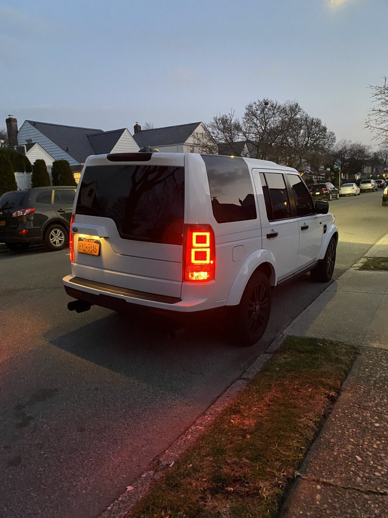

Here it is

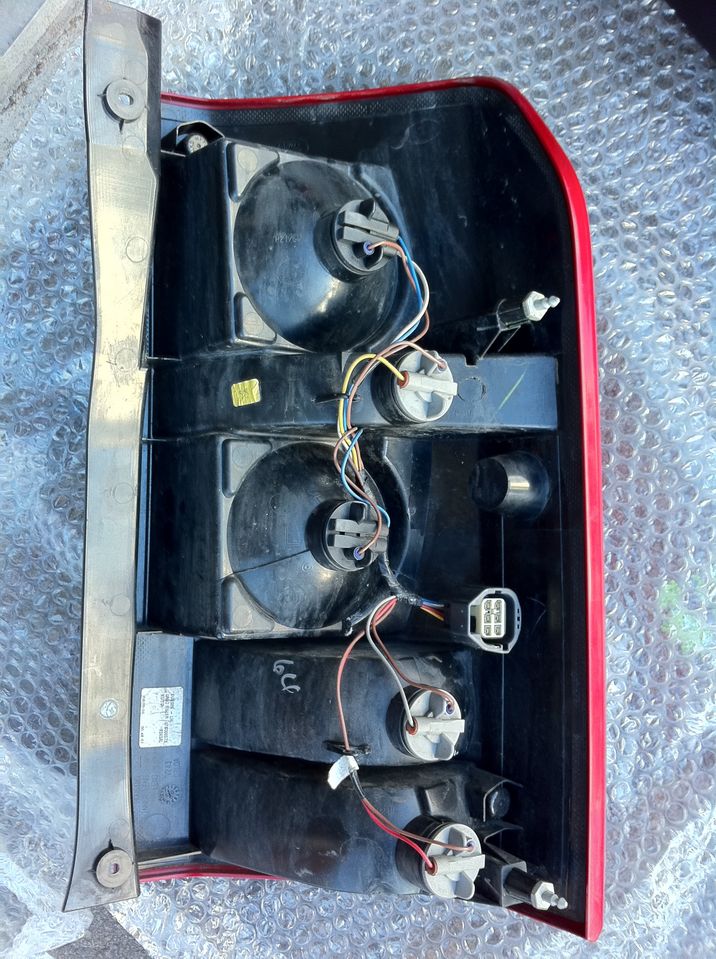

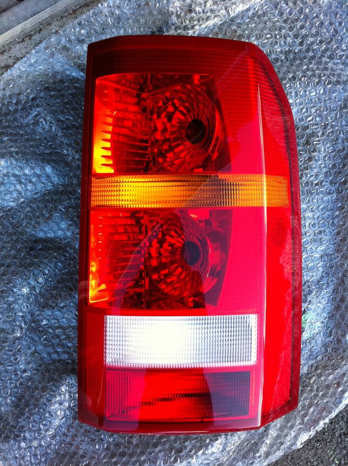

Off subject, those LED lights look quite good - better than the stock LR4 tail lights in my opinion, however I prefer the look of my factory LR3 tail lights as LED is in my opinion not quite right yet - usually too bright at night and generally too small an illuminated area which matters in mud and snow. Also the LED are not as hot as incandescent and hence tend not to melt the snow off.
My only wish was that LR has installed the brake light function re the NAS spec vehicles in all four bulbs, not just the top two - kind of USA pickup like. One burned out brake light filament means you lose half your brake lights instead of just a quarter of them plus it gives the locals "cause" to pull you over.
Needless to say, I have LR spec 12 volt 21W 5W dual filament bayonet base bulbs in the four top locations but I did install LED for the backup bulbs. That does not seem to cause any problems and at night, the LED bulbs provide a higher degree of illumination to the backup camera, a bit of a plus and all looks stock.

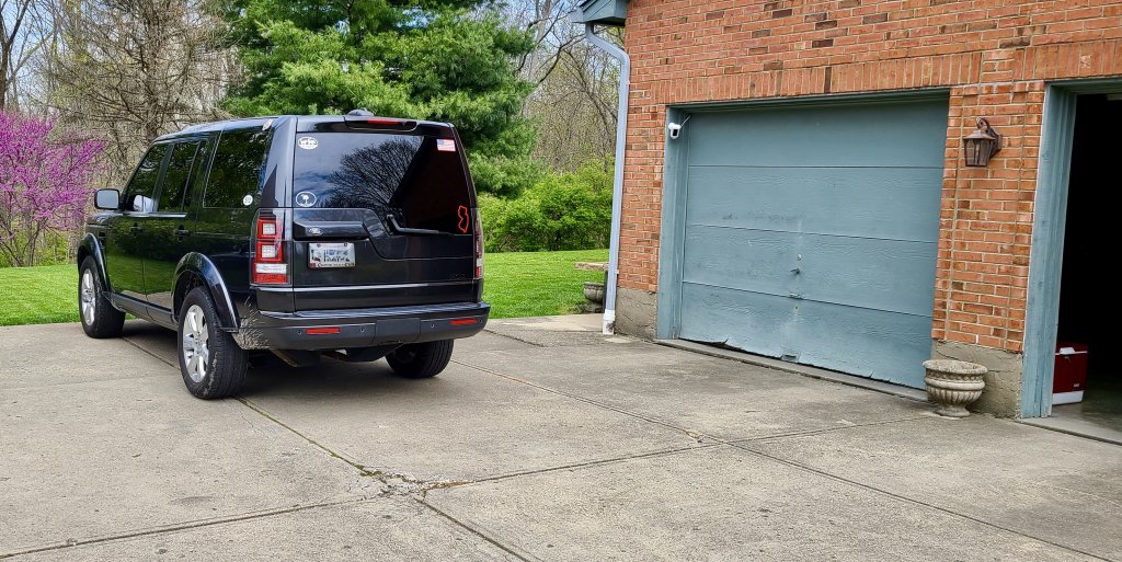

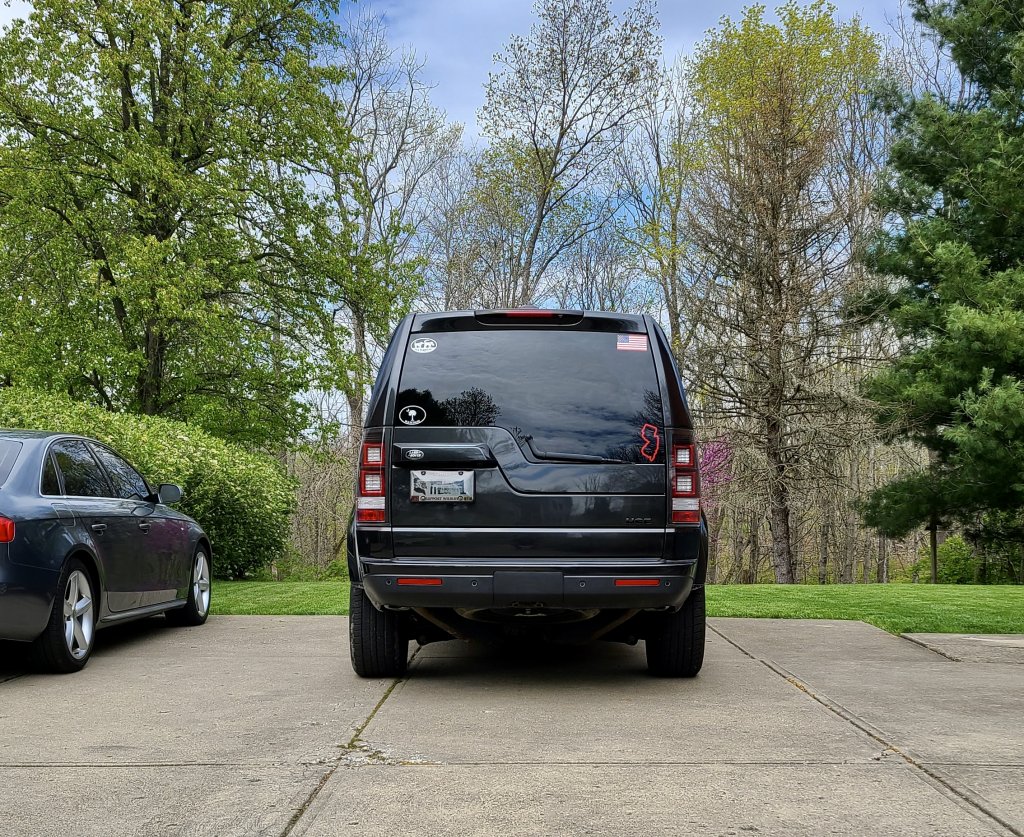

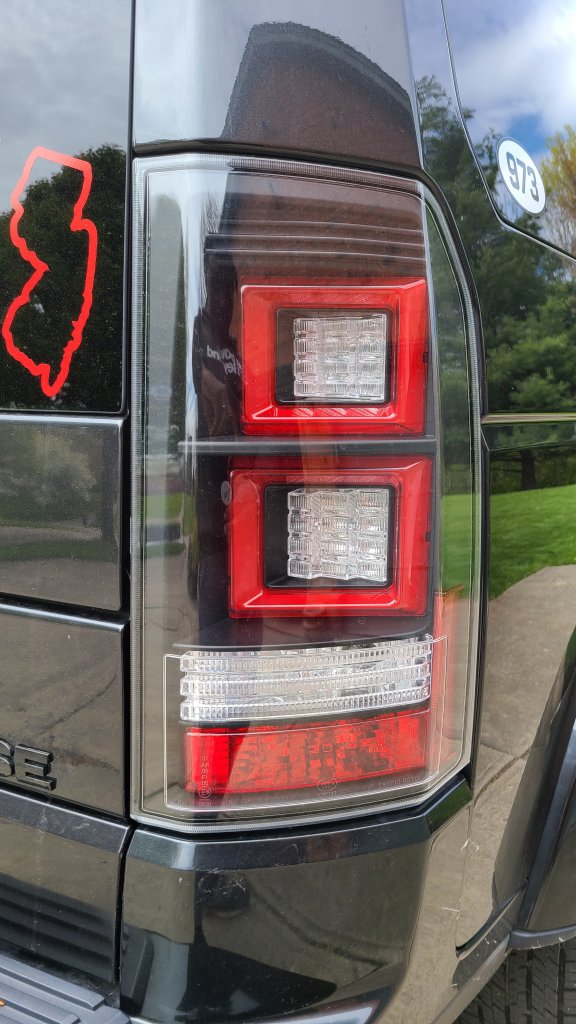

^Thats pretty wild that they're at HD haha. I ended up getting them from ebay that @jlach993 posted. Here are a few pics. I actually really like them a lot. My "smoke" tint for them arrived today but I haven't yet put that on. I think the end result will be pretty cool.
What do ya'll think?

I presume that they flash at a normal rate and that when you connect a trailer, the systems recognize the trailer and disable the backup sensors?
If you were to get the odd transmission or cruise control message indicating something not good, it would just be the LED tail lights.
If so, installing load resistors would probably resolve all. Perhaps these lights already have something like that incorporated within.
Regardless, they look good. The grass and the Audi look good too.
