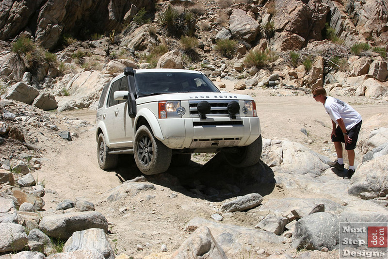

My experience with the Land Rover Raised Air Intake was positive. I did not see any change in mileage, but in fact, did note a small, but perceptible increase in throttle response. At a certain RPM, there was a very slight whistle of air being drawn into the intake, but unless I was holding the throttle at that position (such as going up a hill), it never lasted more than a second or two. Here in dusty SoCal, I did find that my filter was always fairly clean after large group runs to the desert. It's hard to say categorically though, as I was often the lead truck. From inside the cabin, it's virtually invisible from the driver's seat, and makes a very convenient pathway for routing wires up to the roof for lights or antennas.
I installed the snorkel because one of my very first outings in the LR3 was in surprisingly deep water and it made me cautious. That same day I saw a few other vehicles hydrolock due to water ingress. After it was installed, I realized that the snorkel drew more stares and doubletakes from passersby than a flashing strobe light advertising free beer on board. The snorkel is HIGHLY provocative. You will constantly be asked about it, and will become very conscious of all the stares from every age group and demographic possible to find on the roads. I would suggest not installing one if you are shy :)
