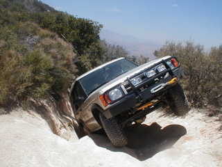

discomike
Guest
Well put, I am curious as to his answer.
My only concern with the receivor hitch mount is the rating on it. Remember looking at the rating on a trailor hitch, usually 350 to 500 pounds tongue weight and no laterial pull, At best they will pull on a straight line basis, the other down fall is the ground clearance is terrible with that sticking out in front of you while on a trail.
Mike J.
