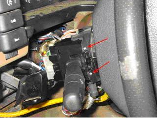

5. Access to two small screws used to secure the switch housing to the steering column assembly is now gained. See picture. Remove these two screws.
6. There are two connecter blocks on the back of the switch, disconnect these.
7. Firmly, but again cautiously, pull the switch from the column. It has probably not been removed since vehicle assembly so will undoubtedly be stiff. This took me a little time to work out, but the switch will ONLY come out if pulled straight out through the direction of the drivers door. There are two tracks on the top and two on the bottom of the switch holding its position so it must slide in and out along these tracks.
