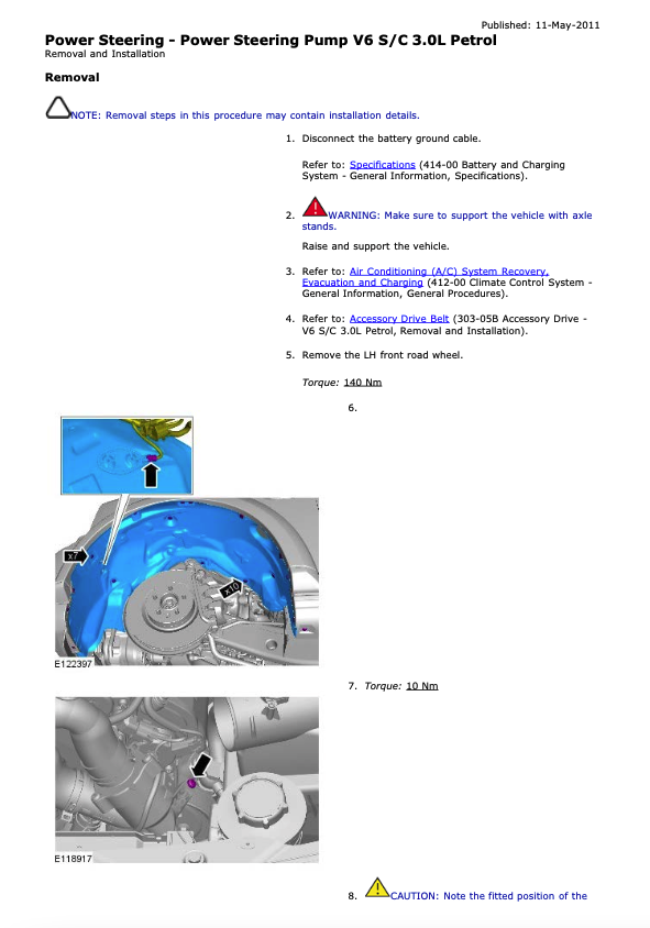

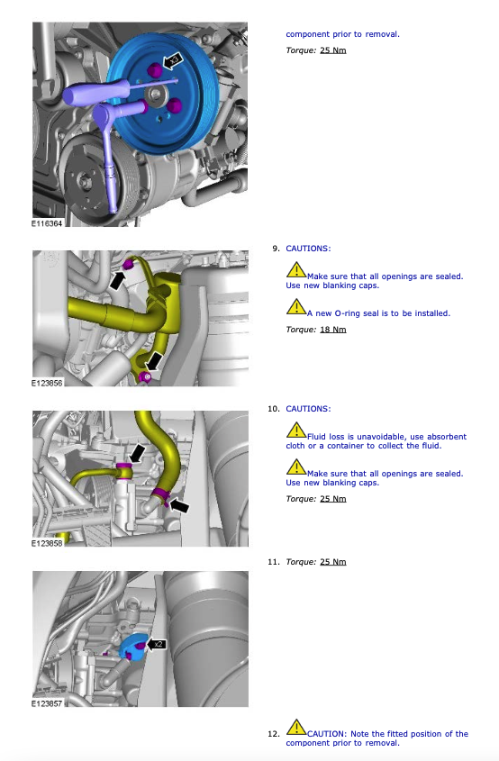

I may be in over my head here! I usually do all my own work. I changed the water pump and crossover tube on my own a year ago. Now I’m attempting to change the power steering pump. ‍♂️ I have found NO videos that show how to do it on a 2013 LR4 HSE. I’ve stripped all the coolant hoses away and removed the fan to get to what I think is the pulley for the pump. Just not sure it’s the right one and even if it is.....how to get it out. PLEASE HELP.

Not sure if this helps at all, given the publication date.

It does make sense. I got the old one out and new one in. The pulley was a bit stubborn and had to be pried off. Once the new pulley arrives, I’ll start the reassemble. Thanks.
