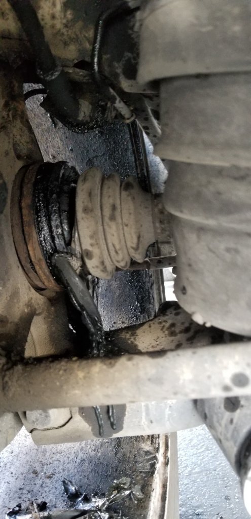

My 2013 RRS did the same but was the CV joint exploding so check your axles as well.
