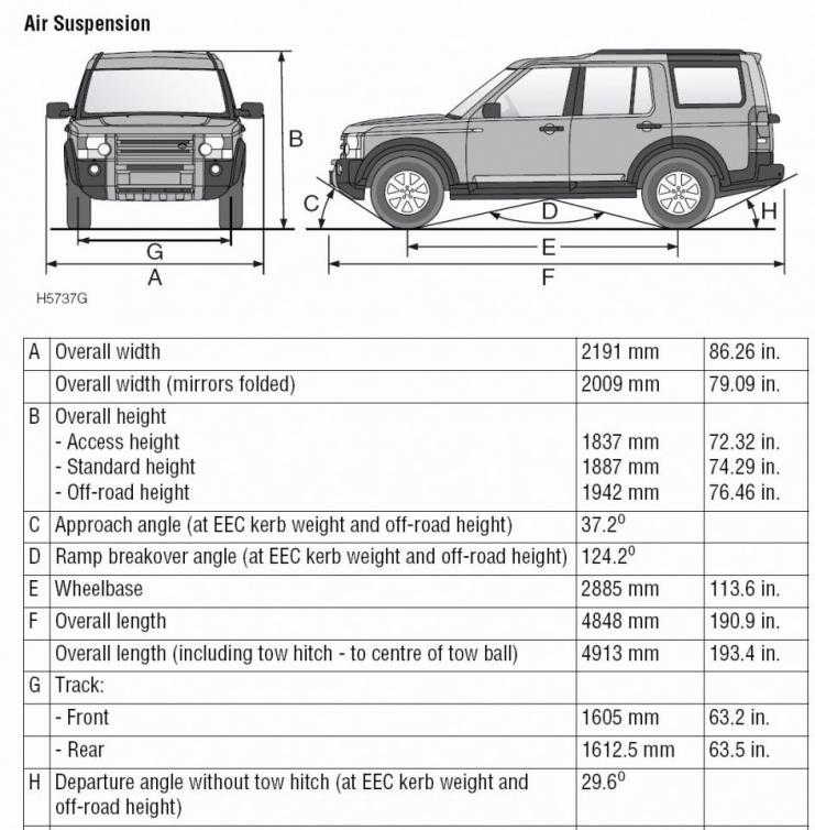

for an LR3, but should be the same.. you can lock the truck in access mode.
2,629
1,292
it can lock in low. The high point is the wart on the back. You should just squeeze in if tires/wheels stock. Can also deflate tires for another 1/2"
