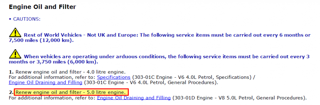

2) Outside USA, factory OCI spec was 7,500 miles for normal service and 3,750 miles for severe service. This, IMO, is far more reasonable. And it jives with the forum wisdom of changing around 5-7kmi under most circumstances; changing at less than 5kmi with severe service would be smart.
Factory manual shows the 5.0L V8 engine as 7500/3750 intervals "Not UK and Europe"... anyone across the pond have a manual which shows the UK/Europe spec?IIRC, that was the factory recommended oil service interval for diesel powered Discovery 4s, which were a much more popular option (in many European countries, the only option) outside of North America. For petrol V8 and SCV6 engines, I believe the same interval recommended in the US - 15K mi /12 mo regularly, 7.5K mi / 6 mo for arduous or severe conditions - applied abroad as well.
