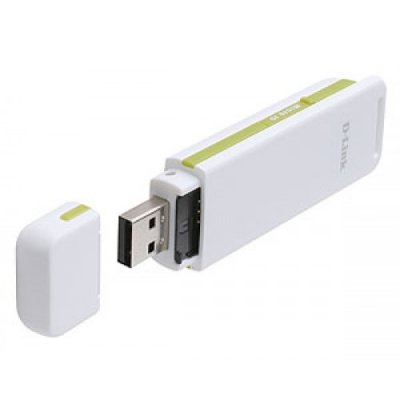

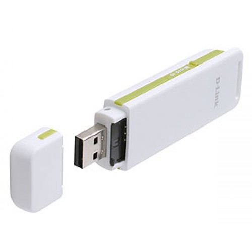

    For the data connection I am using a4g USB router and it is plugged in one of the USBs under the center armrest. No need to turn on/off anything it will turn on once the car starts and will connect automatically.
