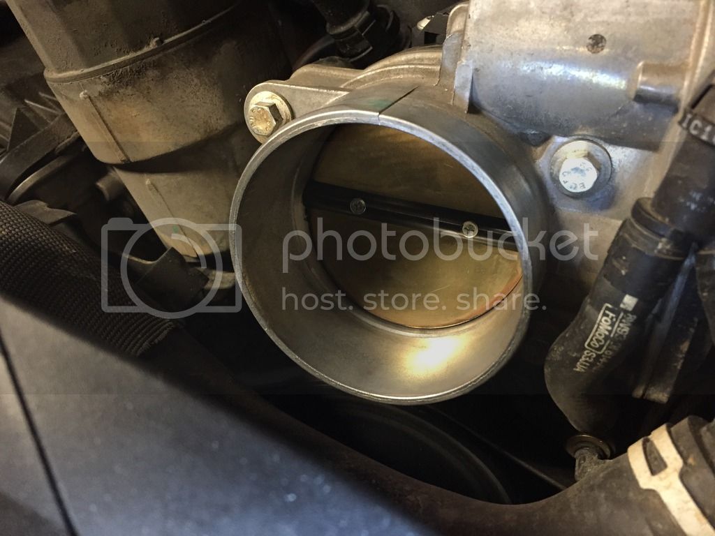

    Cleaned the TB today. It was very clean already. A slight bit of oil on the back side and a small amount of build up in the housing.
    Funny enough the Land Rover service manual actually suggests agains cleaning the TB housing. :stupid:

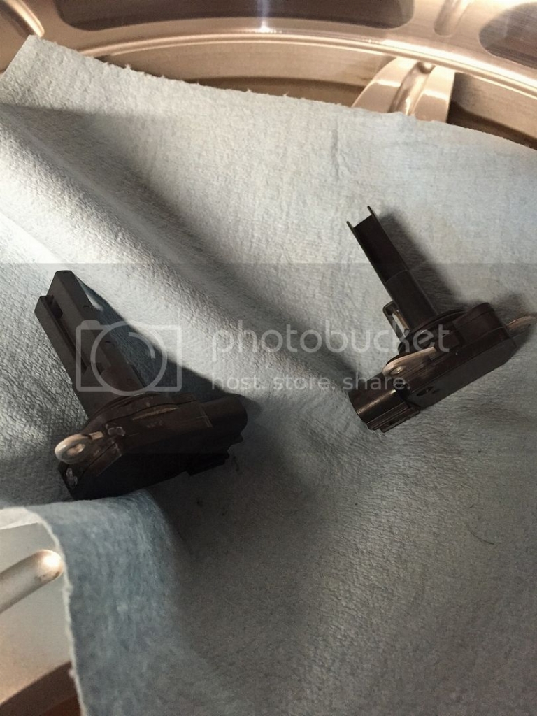

    I also cleaned off the MAF sensors with CRC MAF cleaner.
    [​IMG]
