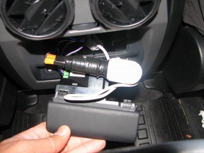

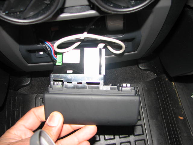

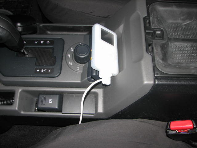

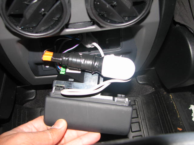

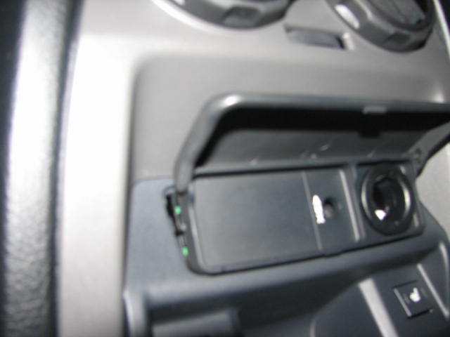

Here are some jpegs of my setup. If you open auxillary cover, nothing is there, its all behind. This part can pulled out with a gentle but firm tug. You can then remove the cigrette lighter port and attach the Belkin adapter to this and tape it together. Next, you have to remover the auxillary circuit board and flip this over. You will need to drill a hole through the back of the housing and feed the stereo plug through this hole and into the auxillary plug. Use a 2ft stereo plug and plug the other end into the Belkin adapter. Then feed the ipod connector part along the side of the console so that it end up as shown in the picture. You will have to stuff into the area and then replace the part that you pulled. Its a very tight fit but with some manipulation and patience, it sticks out minimally and there won't be any signs of your project. All that is left is to crank the tunes.
BTW, I still do not have any hum if I select AUX directly after selecting FM.
