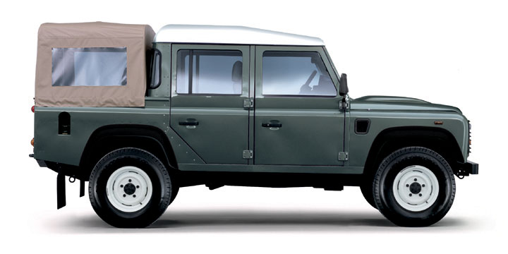

Hello all, I am new to the forum. For years I have been wanting to build a 110 Wagon, but mostly a 110 double cab. I have been talking with a few importers, who have quoted me $85-$150k for an all new build. I want one, but not that bad.
Any input on my options? Any experience building from an ex military and converting to the Double Cab body? I have also read about the TDCI with the 6 speed, but can't find sources or pricing. I don't plan to do much highway, or severe off road, so I don't need a ton of power. Here is a pic of what my end build would be.
Thanks in advance!

Where are you? I assume USA from $'s quotes?
That's silly money. You could order all the parts to build a 110 DoKa from Rovers North for less than that.
Find a decent 1985 or older Defender 110 outside the US and import it for your base. Pay no more than $5,000 for it. Start chasing parts in the UK, where they are cheapest, and you could have a nice DoKa on the road for under $20k with some effort and research.
For the record, a 110 wagon is much more practical than a DoKa in most circumstances. And skip the TDCi, go for a 200TDi or 300TDi without electronic fuel control. Simple is better, and much cheaper.
