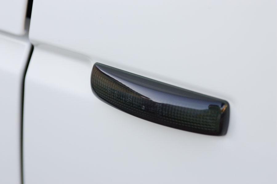

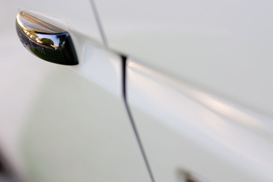

I went with smoked off of EBAY - very happy with the look
You slide the old lamp unit forward against it's metal spring clip - then lift out the back end first. Lamp fitting is a bayonet into the lamp lens.
Refit is reverse - easy to do, just take care not to over-compress the metal spring clip.
Looks awesome. Do you have a part # mine is white too
