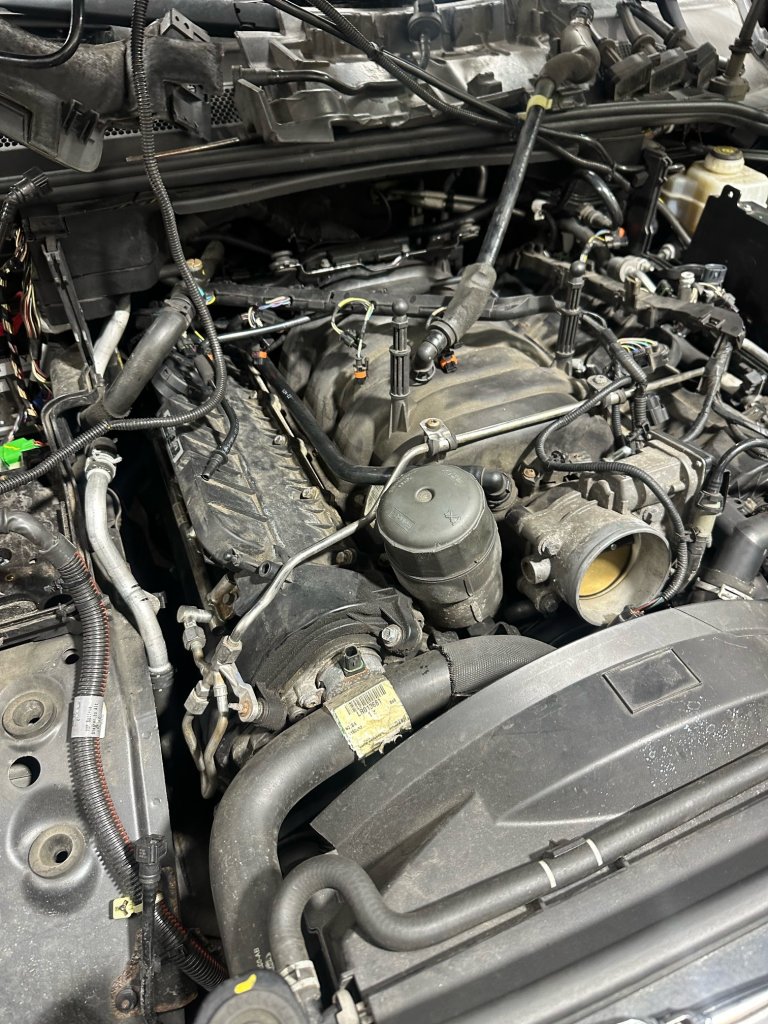

2013 and just had this replaced

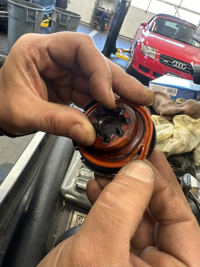

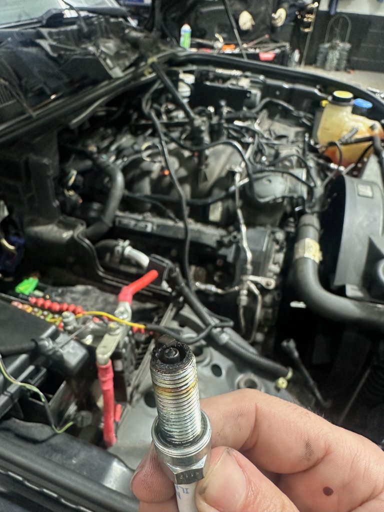

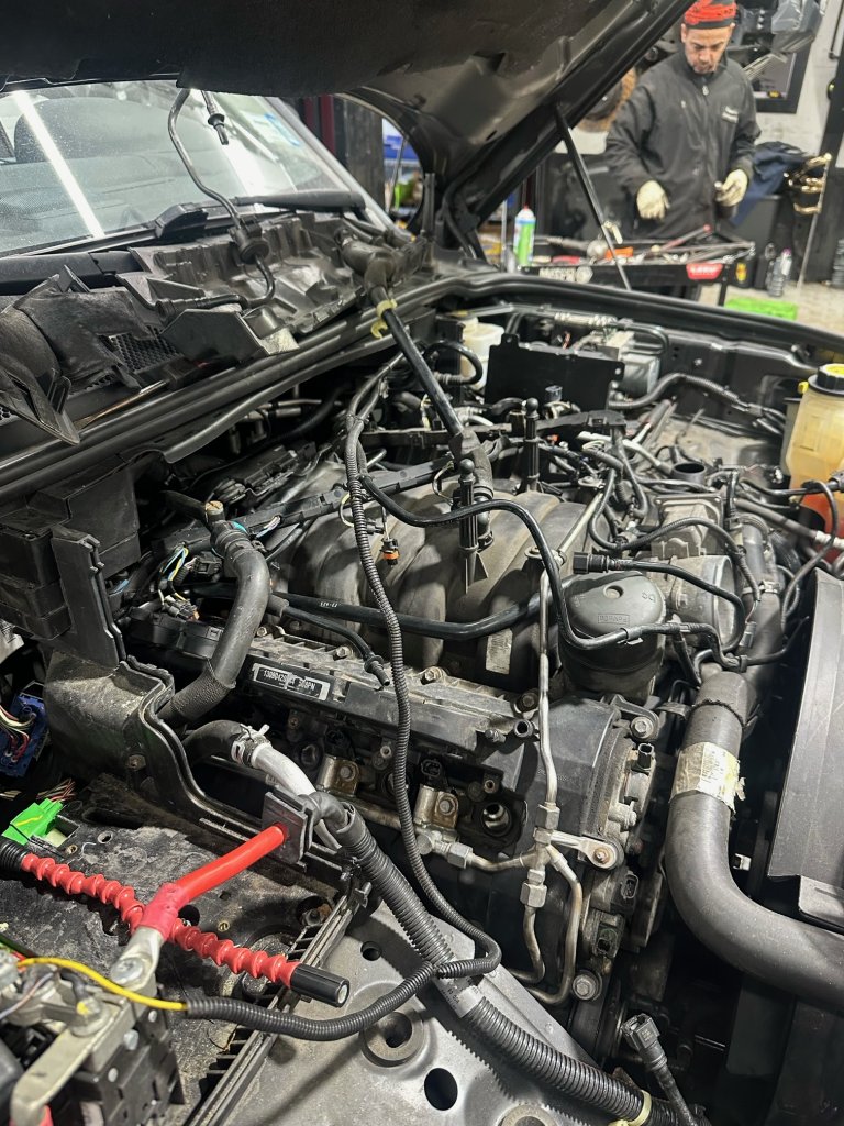

more to come - theyre gonna see if the vacuum pump is still pushing oil into intake.
