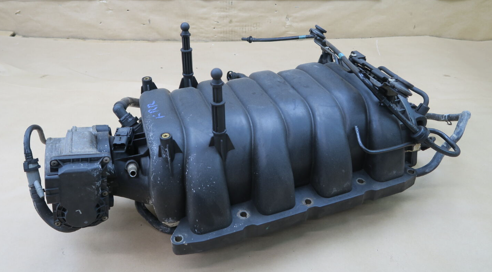

So they drained the oil and never replenished or they failed to top up? How much did you drive like this?
i took it in for oil change which they did. Drove home a few miles and for whatever reason i decided to check the oil on the dash. i was getting 2 different readings using the hood open and hitting the cancel button vs the regular way. it said add a qrt so i did. my gut told me to bring it back to the shop. They called and said the car was missing 5 or 6 qrtz as if they forgot to put in oil. im friends with the shop owner and he is a very honest person. they dug around for a while and figured out the oil went into the intake, then they fixed the vacuum pump, pcv valves etc...but at no point did the car identify or communicate a low oil state.
2,623
1,283
I can't see where a large volume of oil would hide in the intake. A few spoonfuls sure but quarts? The oil would pool on the back side of the intake valves immediately I would think.
