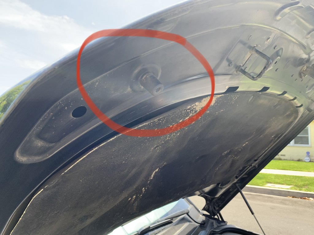

Not so fast. Screw this guy all the way in and try closing the hood (there’s one on each side) There’s about 1” of adjustment in the hood stop to eliminate chatter when driving.
If it closes properly then screw the stop out until it just is at the point of not latching then screw the stop back 1/4 turn.
If this doesn’t work then look closer at the latches themselves, they may be sticking open as mentioned above.

BOOm, job done. there was room for adjustment and the hood shut first try. thanks
