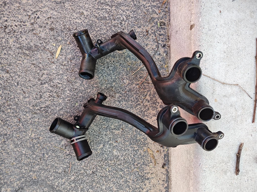

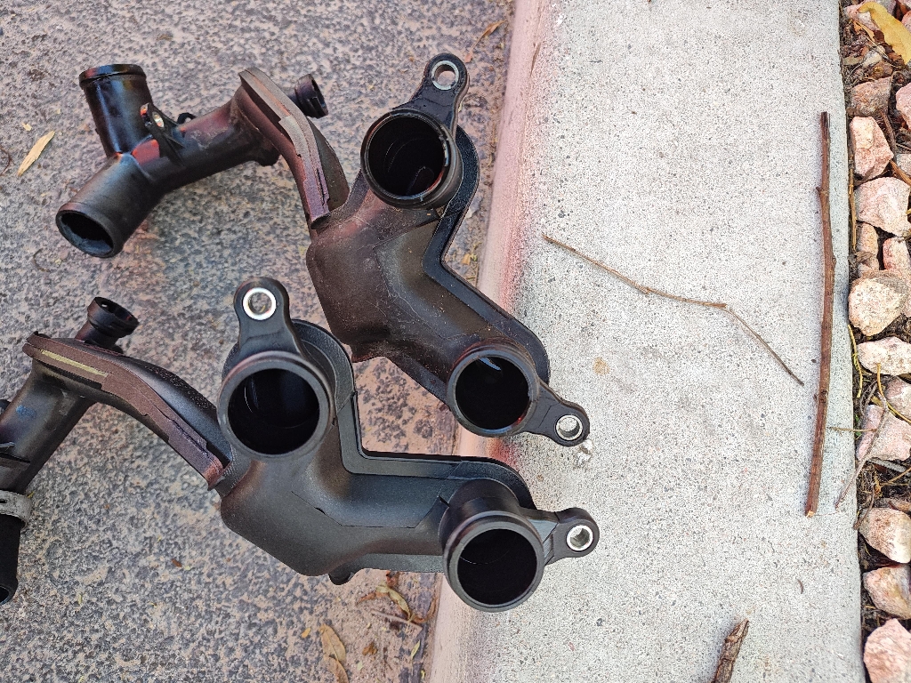

I didn't lube it but there was coolant in the hole so hopefully it will be fine. The old pipe looked just fine to me, but I wouldn't have known that w/out replacing it. Unless there was a weak point unseen I'd guess it had at least 20k left on it but who knows.
