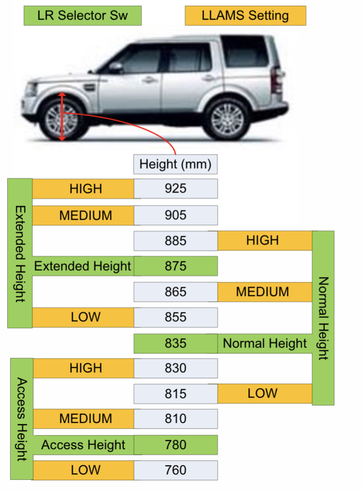

Not sure if these are what you’re after but there are a few option LLAMS Kit, Johnson Rods. I have the LLAMS and have these settings.
