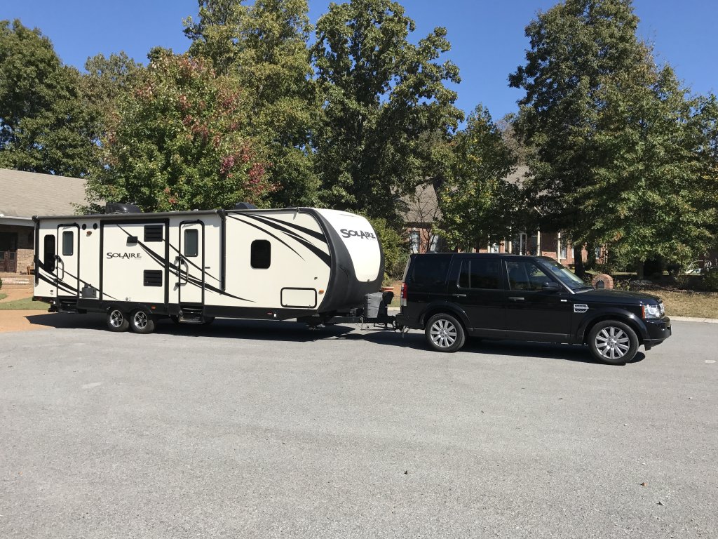

    I just rolled over 100k while towing a 30' travel trailer. I tested several configurations but settled on an aftermarket hitch on the LR4 and an Anderson WD system that saved me about 50 lbs off the tongue weight. I used Cat scales to get the weight distributing system configured correctly and it pulls great. (6925 lbs trailer, 680 lbs tongue.) I did plugs, pads and rotors and had the suspension checked by my local shop. My wife and I are leaving for a month long trip from Indianapolis to the west coast next week.
