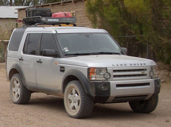

KTMLC8 said:So far so good for my Nittos. I can feel a little more body roll or could be tire sidewall roll while going thru the corners. Only issue is with my expedition roof rack clearance now. I could get into my garage in the access mode just barely and into most low parking garages. The extra one inch height from the tires has halted such activity. I started eyeing the upright structures of the rack to see if I could cut it down about 1.5" - 2". But they seem to be extrusions with top and bottom feet. So I may be yanking the expedition rack and getting the towers and landing pads for my Yakima setup. Anyone in the Dallas area interested in an Expedition rack?

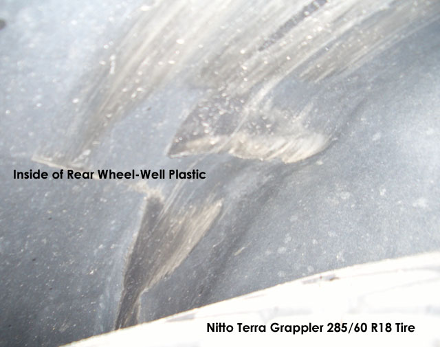

Hmmm, is there any way to prevent this with these tires? they're only slight larger than stock???AdvRide said:Interesting about the rubbing on the Mexico trip. I noticed on one really bad road that I heard what sounded like tire scrapes in the rear wheel wells one day. And upon inspection saw that the rubbing was in the same spots you show there.
AdvRide said:cbboard, I found a solution to my Land Rover expedition rack height. After I removed all the plastic covers from the risers I discovered they were bolted to the top and bottom pieces. So I simply removed the risers and the top of the rack. What I have on the truck now is basically the bottom of the rack which leaves the cross sections to protect the glass top, the sun roof and still allow be to strap down things with the eyelets. I think I can even get the Yakima Load Warrior basket to attach to the rack now which will work out for what I need.
