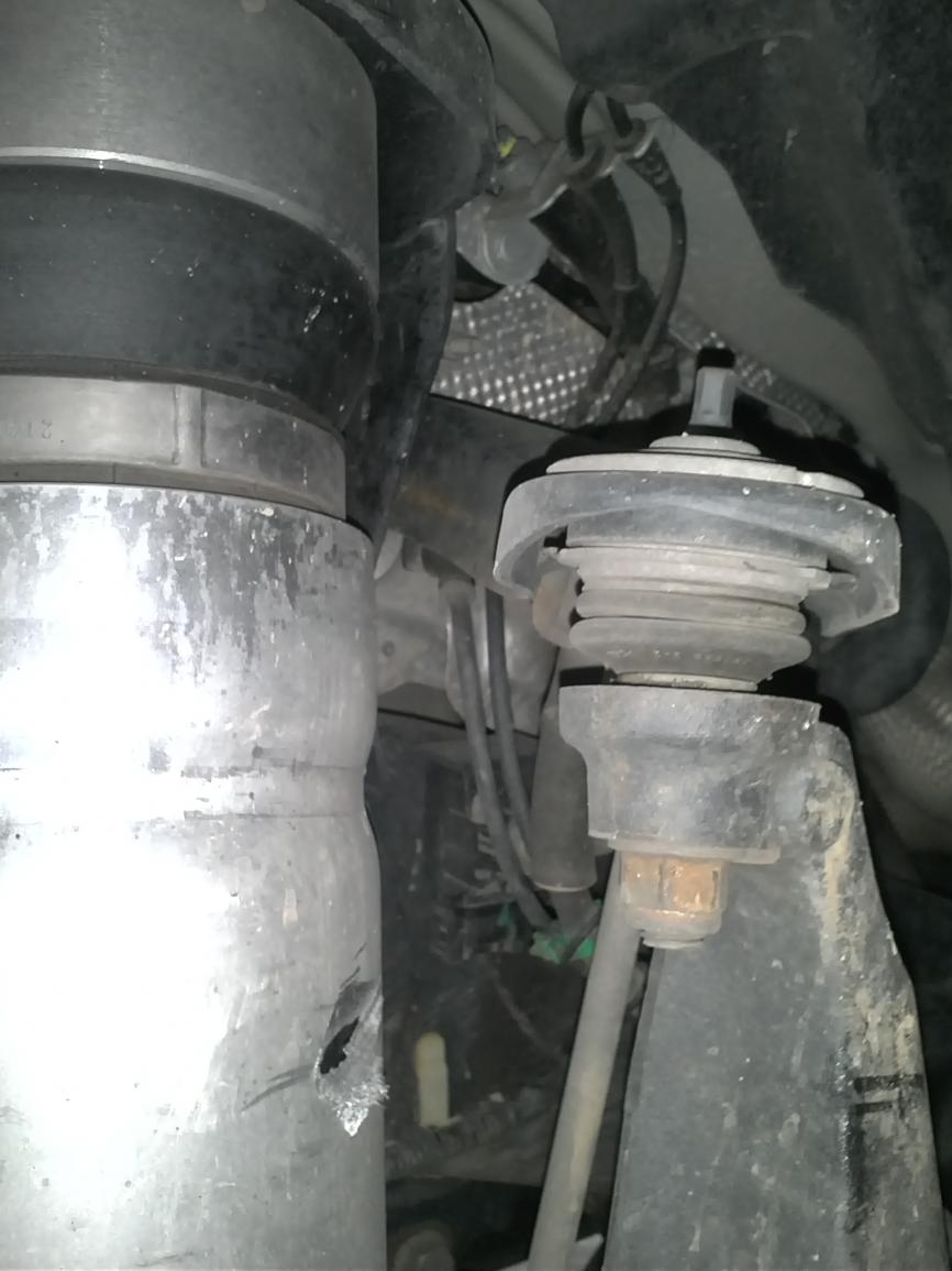

Well, ran Mosquito Pass with a couple of friends this weekend. A typical beautiful Colorado fall day. About halfway, after you make the first "climb" and it flattens out "POP . . .sissssssssss". I rubbed a hole in the canister of the right side front air bag.
The good thing, an LR3 can run a class 4 trail on it's bump stops (super uncomfortable though). The bad thing, now I have figure out what was rubbing against the canister. I have a spare, so other than busted knuckles and time, I'm good there.

Welcome to the club. Did the same to my first one over 2 years ago. Same strut same side. Couple of things you can do, refresh the bushings on the front and install a NEW front strut not a used one. The consensus by myself and others with the same problem is that as the strut wears the shock seems to extend further then it did when new causing the upper a-arm to contact the spring at full extension. If you go the used strut route depending on how many miles are on it you will be that much closer to it happening again. You aren't the first and won't be the last.. I will say that this was the final problem that pushed me over the edge with the LR3 (When it started happening with the second strut just 2 years later). I have since gotten rid of the LR3 and am on the hunt for a Defender 110.

Wow . . .was really thinking the Toddco lift I put on contributed to the problem. I was working on putting the "old" struts back on this afternoon, couldn't figure out how/why the upper control arm was hitting the canister, couldn't get it to hit.
I had new canisters (all four, bought from Land Rover Parts.com) installed with the lift (seemed like a smart thing to do) and I had new bushings installed THIS WEEK with an alignment at the dealer.
BUT, the upper control arm is definately the cause of the gouging and ultimate "pop' of the bag.

I didn't pay attention to your signature. The rod mod on its own has little effect on the suspension problem you are having. However the Toddco Spacer lift is a big problem and certainly accelerated the failure happening. If you are going to run the spacers you must design some sort of limiting check strap to prevent the front wheels from extending too far causing the a-arm to contact.

...I rubbed a hole in the canister of the right side front air bag.
The good thing, an LR3 can run a class 4 trail on it's bump stops (super uncomfortable though). The bad thing, now I have figure out what was rubbing against the canister. I have a spare, so other than busted knuckles and time, I'm good there....
How does the LR3 run after the airbag pops? I would think it would force you to access height, low gears, low speed or something annoying. I've had to limp off a beach after sensor problems which caused the computer to lower my truck with my differentials dragging in the sand and threatening to dig me a grave! Can't imagine how you ran the trail (if the LR3 didn't let you keep the other 3 bags inflated.)
Have a picture of the damaged canister? I'd like to look at mine to see if there is any abrasion, but i'm not sure where to look.
Good luck!
Here's the picture of the front strut canister.
