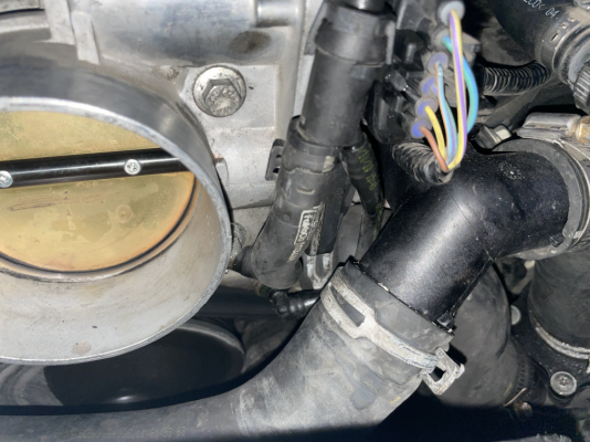

Got the rear crossover and front one changed out. The o ring in the rear passenger side disintegrated. I put everything back together and now I have a leak from the elbow that pushes into the water pump. I am looking for the replacement part number but the hoses don't match.
It looks like a 1/4" line that comes off the Y and then has a push in elbow into the water pump.
Any help on part numbers would be appreciated. The wife is growing frustrated with my mechanic skills.
