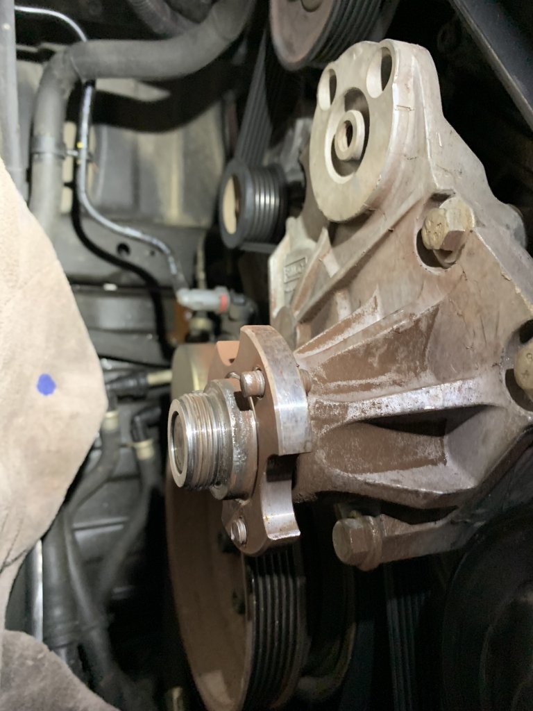

Check the fan belt and pulley housing. I had similar symptoms and it was the belt, dealer had installed a shorter belt than required and the bolt heads had sheared off, roaring sound. New bolts and proper belt and good as new.

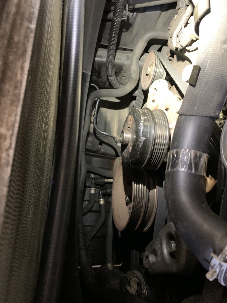

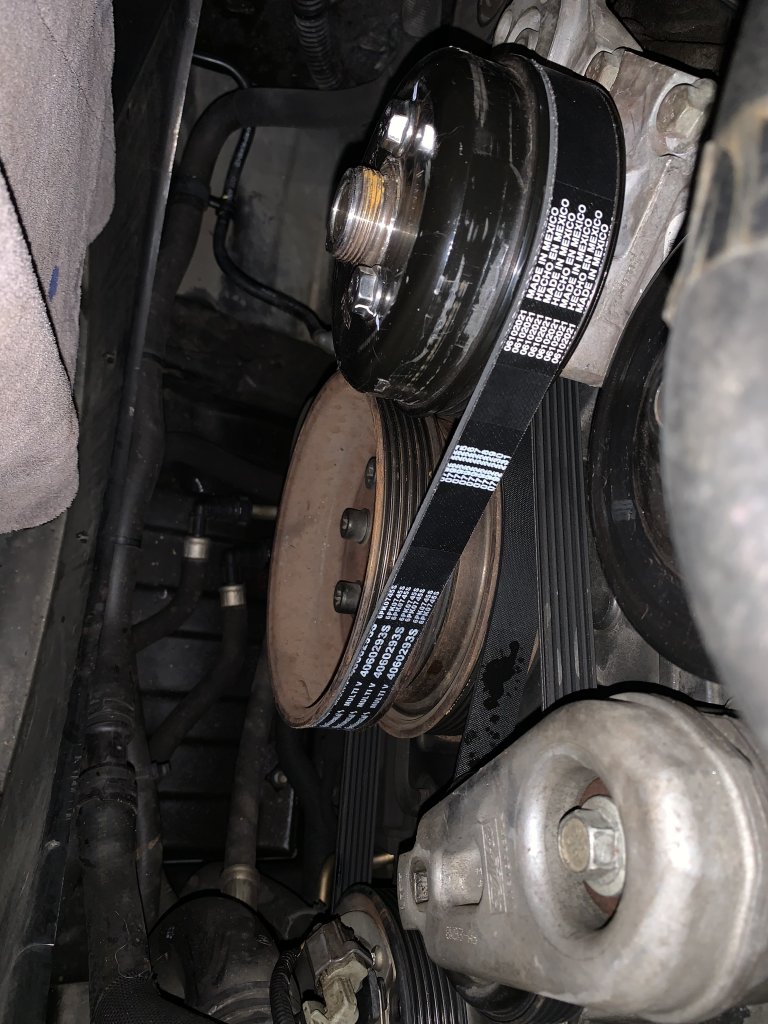

This is the hub I was talking about. The bolt heads sheared, dealer put in a 720 belt instead of a 745. The water pump is behind the hub, studs came out by hand. Middle pic shows it all replaced.
