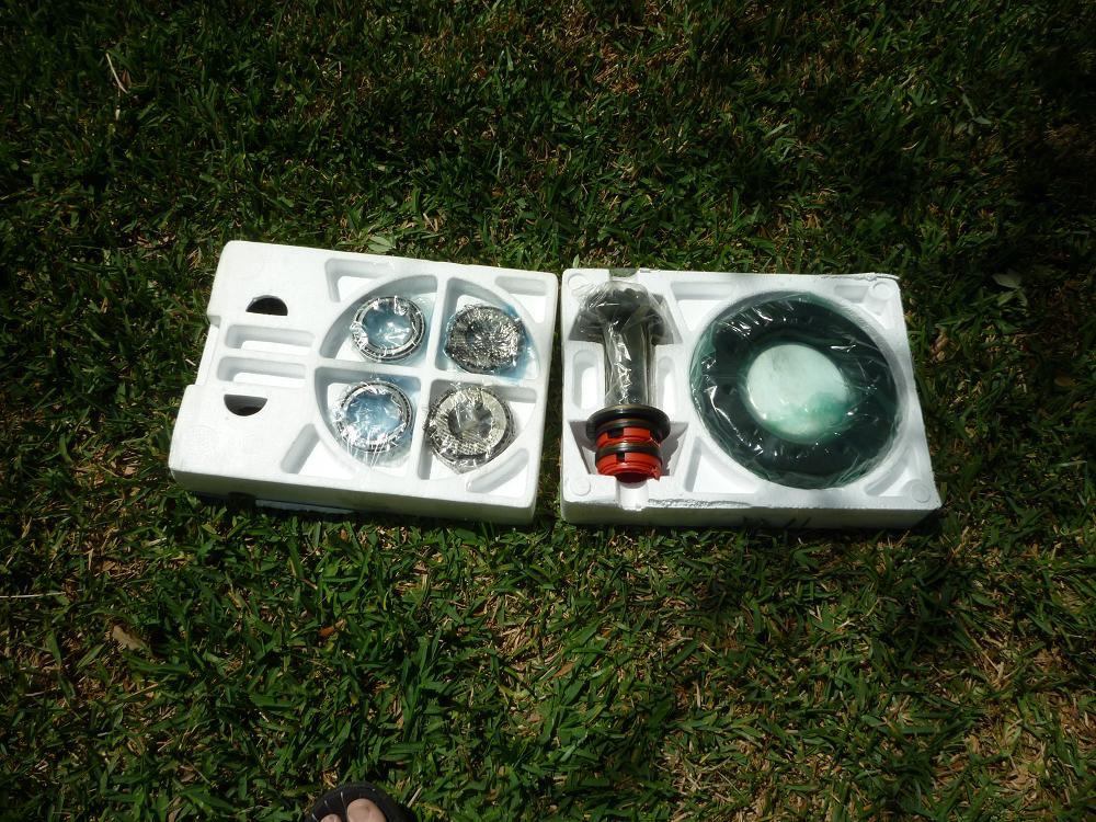

It sounds similar situation to mine. The issue is your differential bearings I am guessing. The single biggest clue is;
3) noise louder when turning left, very slightly quieter turning right
The only other things to check are front wheel hubs, bearings. A reputable shop should be able to lift the wheels off the ground and put a stethoscope on it and confirm the noise at the bearings, etc.
Should this be confirmed to be the issue PM me, and I can get you a rebuild kit. The parts are not available from the dealer individually. The only thing you can buy are the diff seals.

Hi tlt - I looked at Houm's thread that you posted to just now; I'm not seeing any similarities in his descriptions to mine, though I'm certainly not ruling out the diff(s)! The sound is what I find so different - it's a repetitive thrumming (when I refer to "frequency", I'm not referring to pitch, merely the speed at which the thrumming occurs matching the revolutions of the tires). Again, like running over rumble strips on the road that are spaced just a few feet apart...
In any event, I'll likely be swinging by a mechanic in the next few days - if it does happen to be the diff, what's the price like on the rebuild kit?
