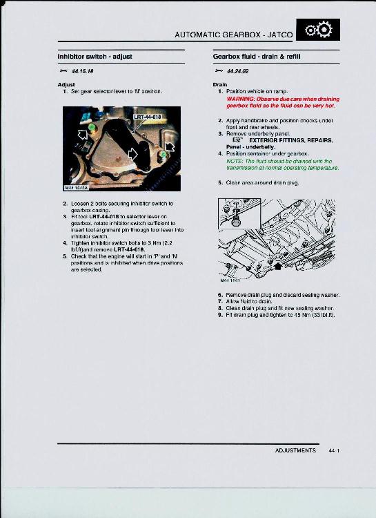

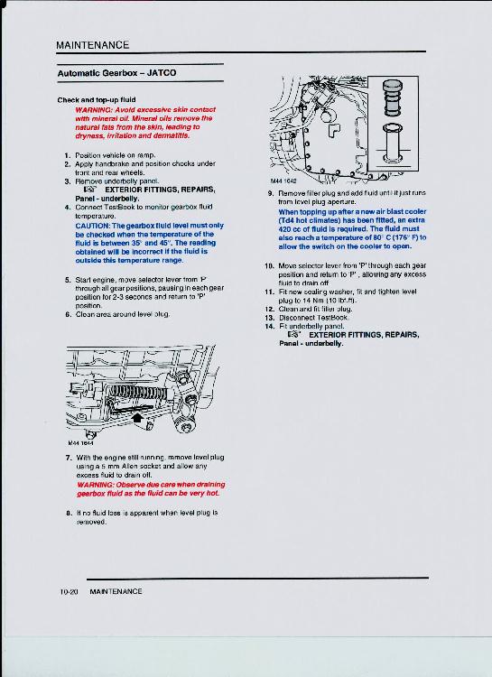

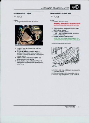

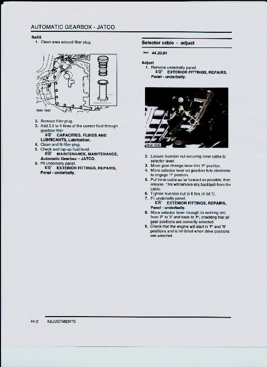

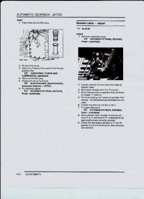

My print-out of the service manual only made them ignore me further. So at 50kmiles I ordered a full box of LRN-402 and printed-out the service procedure along with the a new sealing washer for the drain plug.
At about 53 kmiles when the fluid arrived what came out of my then noisy Jatco was a rotten, smelly mess. The fluid looked like it had rust mixed with water and a whitish foam. Obviously driving in latitude 18º with constant 70% humidity will turn almost any transmissionm fluid into a brown, smelly mess in less than 20kmiles.
I replaced the fluid following the factory procedures sans TextBook PC system and my car ran 110% better, the tranny noises went. I understand that 1/2 of the original fluid always remains in the transfer case, so one can never change the LRN-402 100%, only at best 50 or 60% of the fluid will be new, depending on how aggressively one changes the LRN-402 fluid.

I re-checked the LRN-402 fluid level on Sunday and I was able to drain about 10 oz of extra fluid and my car runs much better.

If you need me to scan and e-mail the procedure from the factory manual let me know. Be warned that any service to a Freelander w/o the Textbook PC interface is not recommended. But the costs of servicing are so high that since the warranty went, I do most of the work myself as I was raised fixing MG's and Honda's.
Remember, modern cars need special care and always the Factory procedures need to be followed as closely as tools and material permit.
