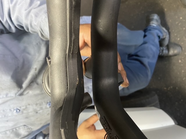

And last snag before completion is that the new coolant Y pipe apparently is a new design. It does not fit the elbow and crossover that I had replaced a few thousand miles ago. So I had to go back to the dealer and drop another hundred $ on a NEWNEW crossover.
Here is a picture of the design difference. Apparently the old one is more of a two piece sandwich construction. And the new one is more of a unified mold process. Parts guy said most failures were along the seam of the old ones. View attachment 10262 so in sum if you want the new mold process you need to buy both the Y pipe and the crossover. And don’t forget that bleeder plug because it does not come in the new pipe.
here’s to hoping the new pieces last the life of the car.

And not sure on part numbers. They are different but the dealers only Spec the new ones. FYI they are not interchangeable. I thought I could buy one piece but they didn’t all fit together. Had to kind of do all the pipes

I updated mine as well to the new style front crossover pipe. The weak link in the cooling system at this point seems to be the rear crossover as it has not yet been updated. I changed my rear out as well even though it was the same but new while doing a bunch of maintenance parts.
