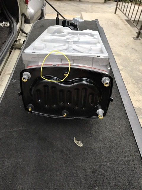

Also here is a picture of the fill/drain plug. Had a hard time finding it as most m112 applications drain on the snout C4848856-9BEF-4F15-9AD3-16746F2FA5A9.jpeg

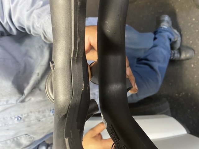

And last snag before completion is that the new coolant Y pipe apparently is a new design. It does not fit the elbow and crossover that I had replaced a few thousand miles ago. So I had to go back to the dealer and drop another hundred $ on a NEWNEW crossover.
Here is a picture of the design difference. Apparently the old one is more of a two piece sandwich construction. And the new one is more of a unified mold process. Parts guy said most failures were along the seam of the old ones.
so in sum if you want the new mold process you need to buy both the Y pipe and the crossover. And don’t forget that bleeder plug because it does not come in the new pipe.
here’s to hoping the new pieces last the life of the car.

Final note on this job is that there was next to no oil in the supercharger. Took all 8oz of oil and almost nothing came out. Lesson here being you may want to check your own oil level as my truck only had 75k miles on it and was way low.
Here is a picture of the design difference. Apparently the old one is more of a two piece sandwich construction. And the new one is more of a unified mold process. Parts guy said most failures were along the seam of the old ones. View attachment 10262 so in sum if you want the new mold process you need to buy both the Y pipe and the crossover. And don’t forget that bleeder plug because it does not come in the new pipe.
Interesting that they made a change that will make that part more reliable...hopefully. Any idea when the update part was introduced? Haven’t heard anyone else mention the updated part before. I have a 2016 might have to go take a peak under the hood.
Not sure. Seems recent.
