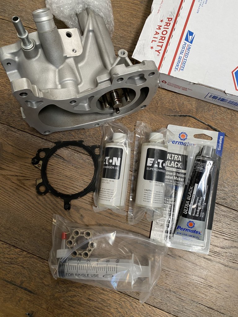

Got my snout kit from Ed. Looks solid. Came with basically everything needed to fix the rattle. I did, of course, go with the pulley upgrade to squeeze a few more ponies out of this mill. We will see how that works with the velocity ap tune and lower pulley. Talked to those guys and it should basically be plug and play. Maybe 30hp? Not sure really.

Exactly my thoughts. I bought the rear crossover and i got the needed parts for the supercharger from Ed. He didn't think that you need to pull the whole unit to get the snout off, though... So i am not sure if the access to the crossover will improve or what, but regardless i am going to have my guy replace that piece. Anyway, so far so good on Ed's end. Ordered friday, arrived monday to CA from PA... Amazing. Thanks for the video, will check it out.

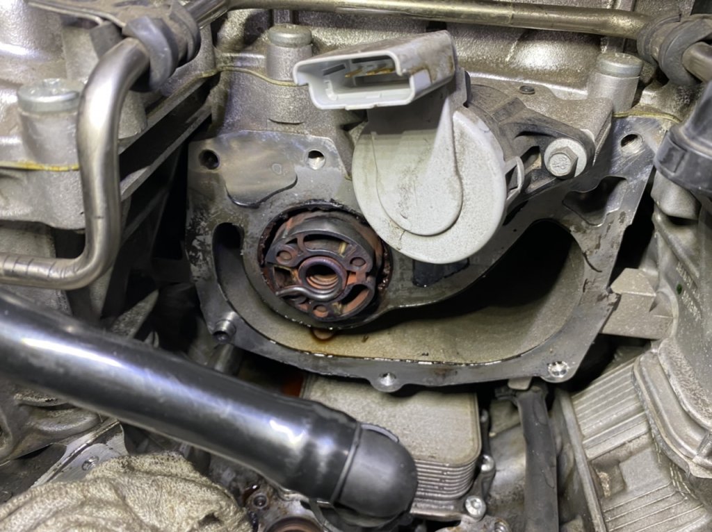

Issues so far have been the water pipe LR050935 and it’s two bolts. It cracked on removal. Did not replace that pipe when we did the crossover because you need to remove the snout or whole Sc to get to it. It was brittle and broke.
And the water pump and oil filter stand had to come off requiring new gaskets. Not a big deal but I guess you have to decide if you want to just pull the snout or to pull the whole SC. We opted for just the snout.
As you can see I got no deal on those pieces buying locally and last minute. Ouch for tiny parts. here are some pics. Now you can see the wear caused by the broken spring on the shaft of the snout assembly. And you can see the old coupler on the SC.
now we are heading into the rear crossover and put it all back together stage.
