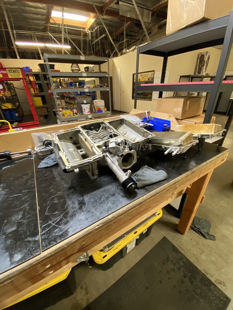

F8BA5B3A-9716-4E87-A230-031C8BDF3873.jpeg Update. Got the unit off the truck and up to superchargers online in Simi Valley. They rebuild a ton of Eatons. Here is the bearing noise. https://youtu.be/glHOyO1Z2dc
T
hese guys are legit and will get to the bottom of the issue. May or may not need new vanes. We will see.

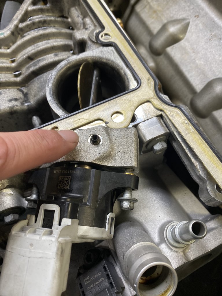

here is the unit on the bench at their shop. 74044093-43E7-43FF-9C7C-C8877A4A5E67.jpegmans a picture of the set screw for the bypass valve that my Indy mistakenly left half way out. This may have caused the butterfly to stick fully shut (boosted all the way) which during throttle off may have caused the ecu to go into limp mode. This would explain my half power issue which went to normal on restart. Now we still have to see what went wrong internally. Might have blown a seal and ingested it or something. Not sure yet.

bypass stuck fully closed or fully open would cause problems. I thought there were oil fills front and rear on these since they have gears and bearing at both ends?
