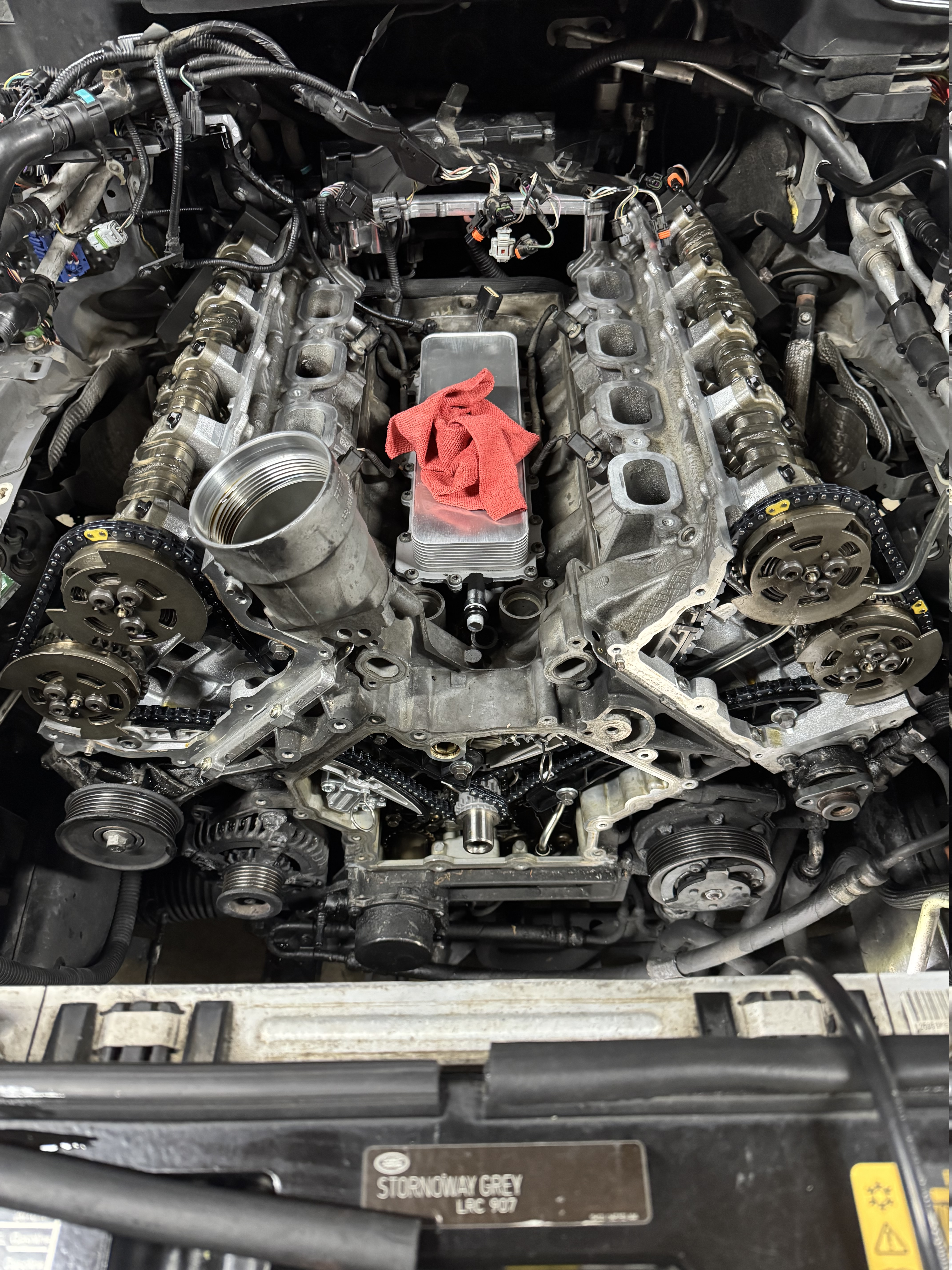

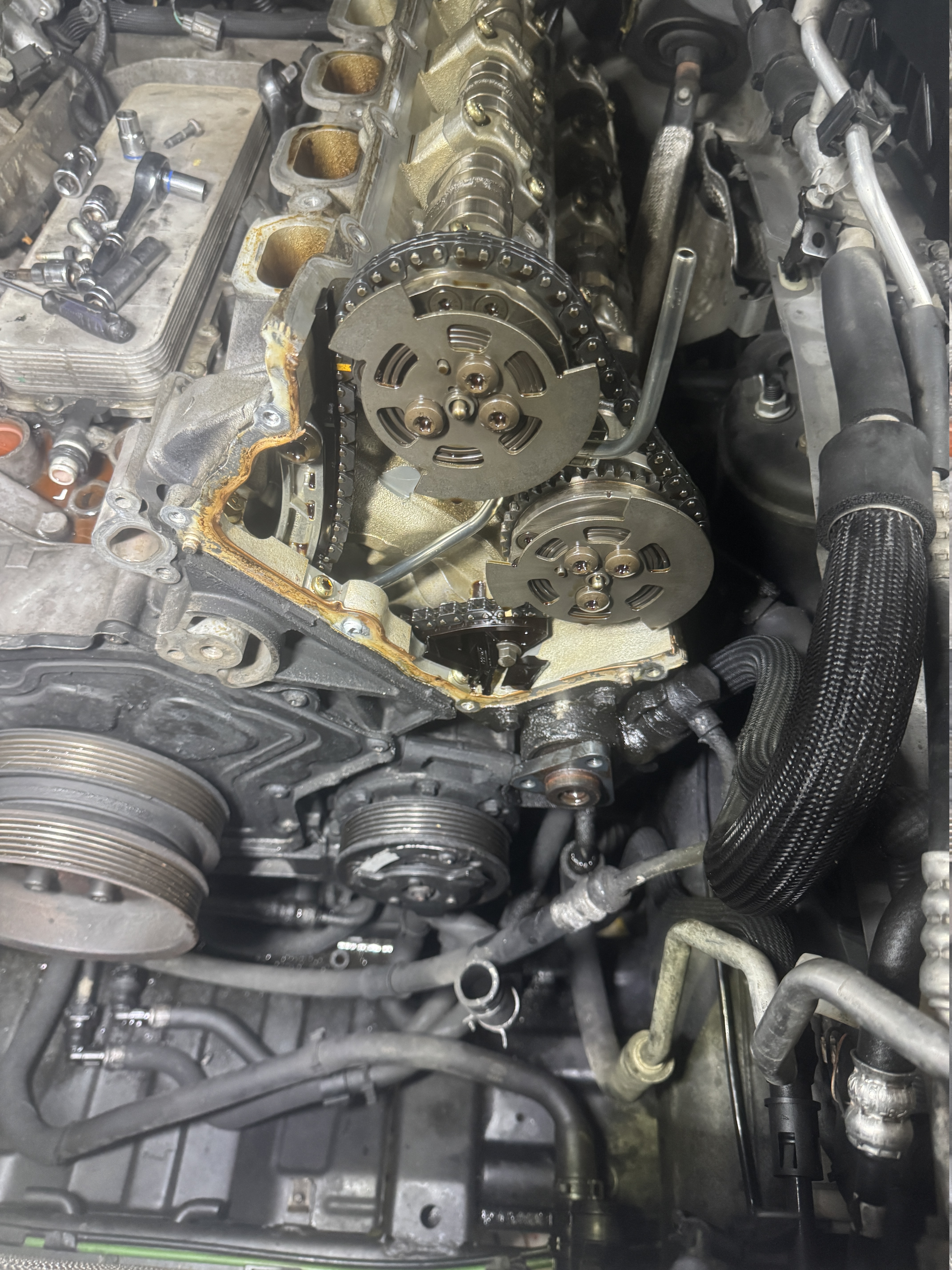

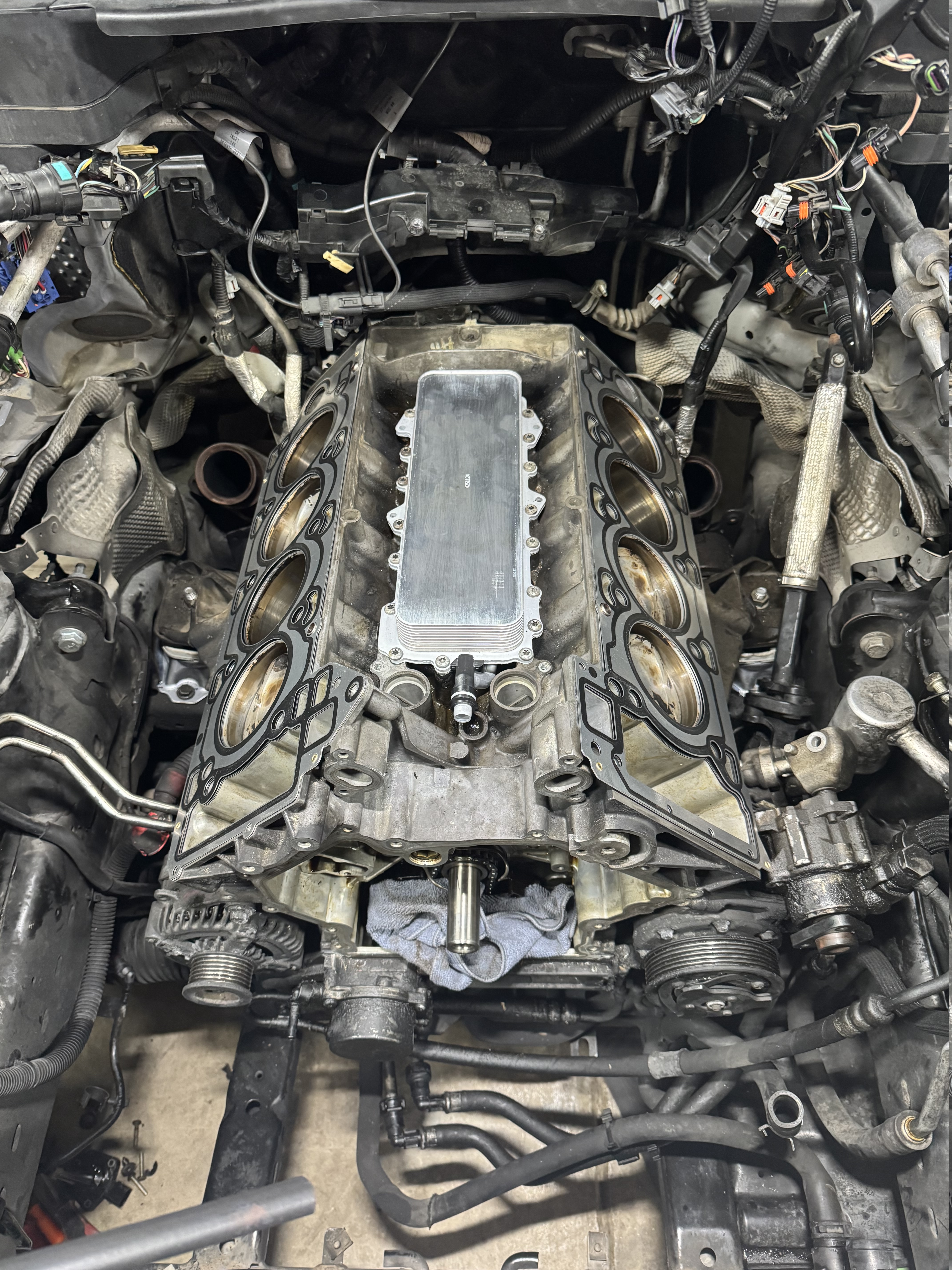

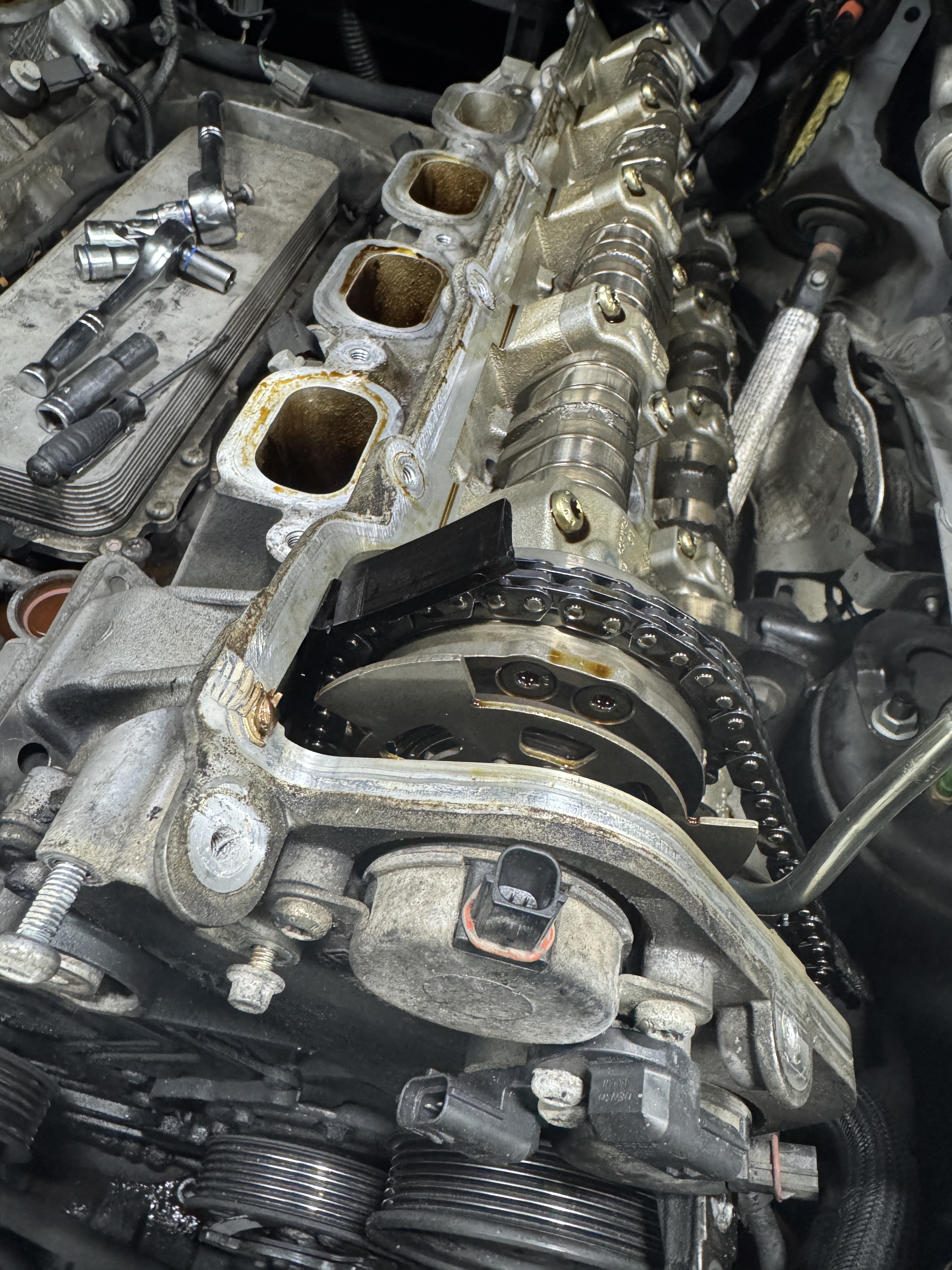

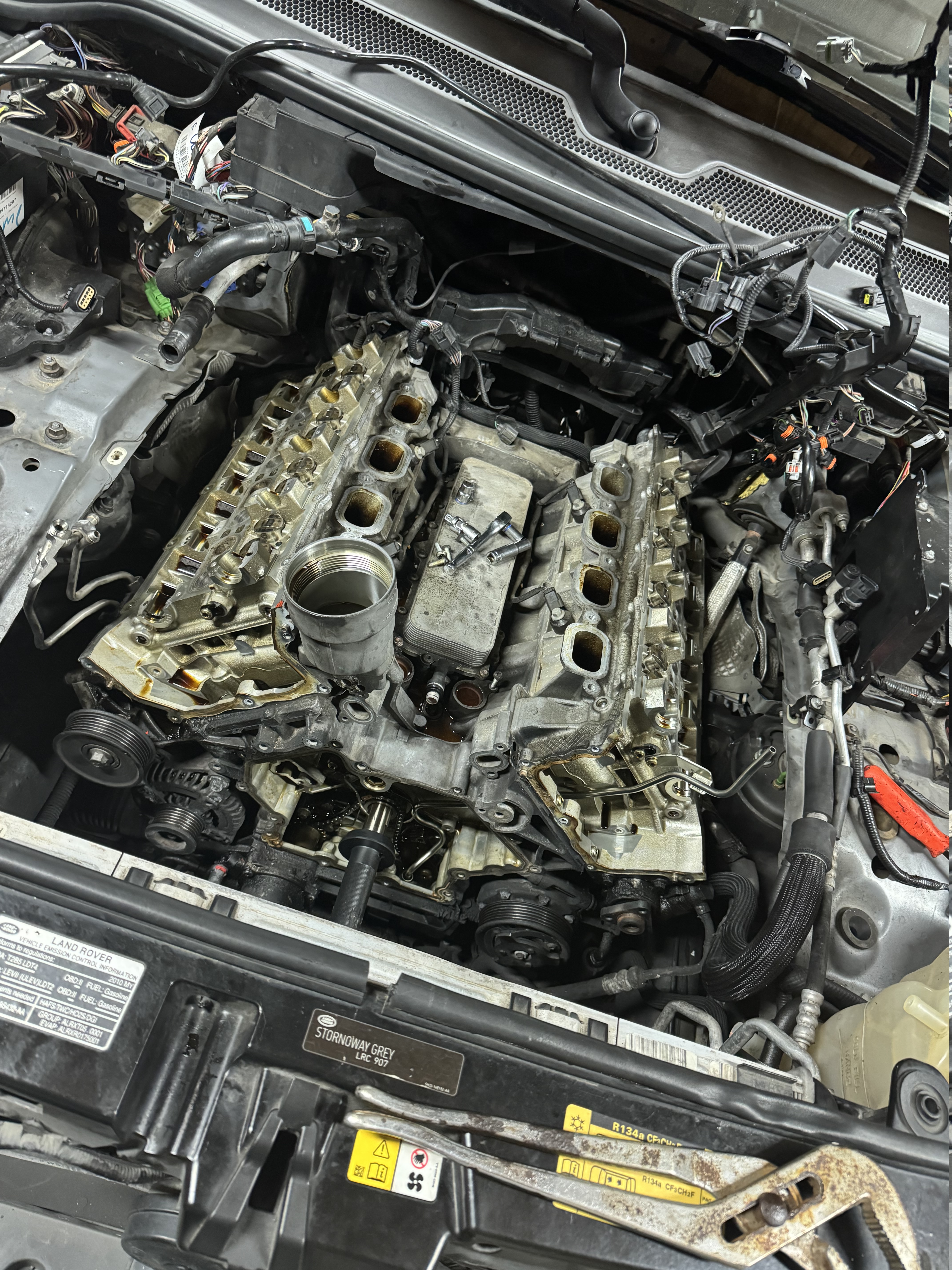

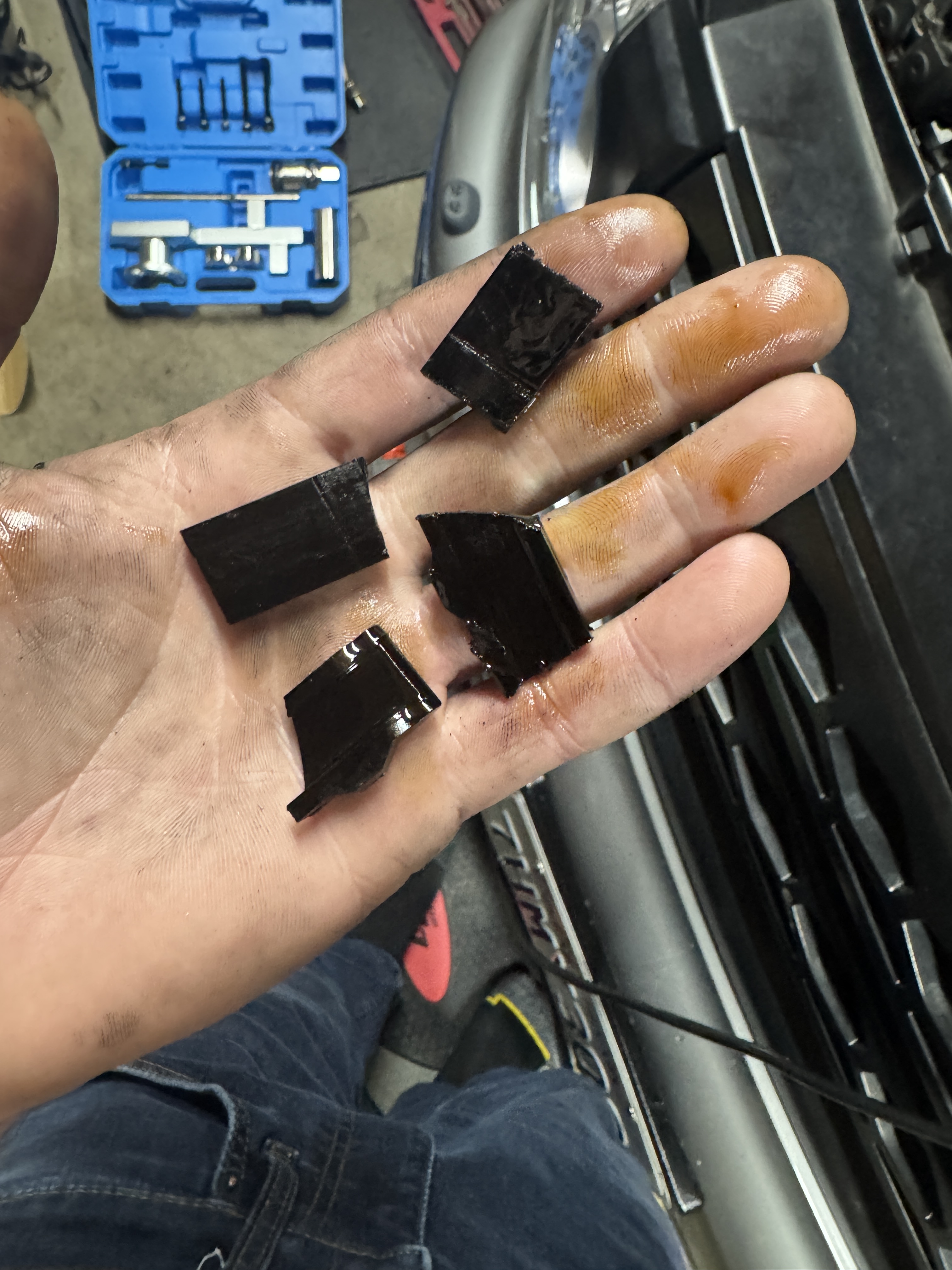

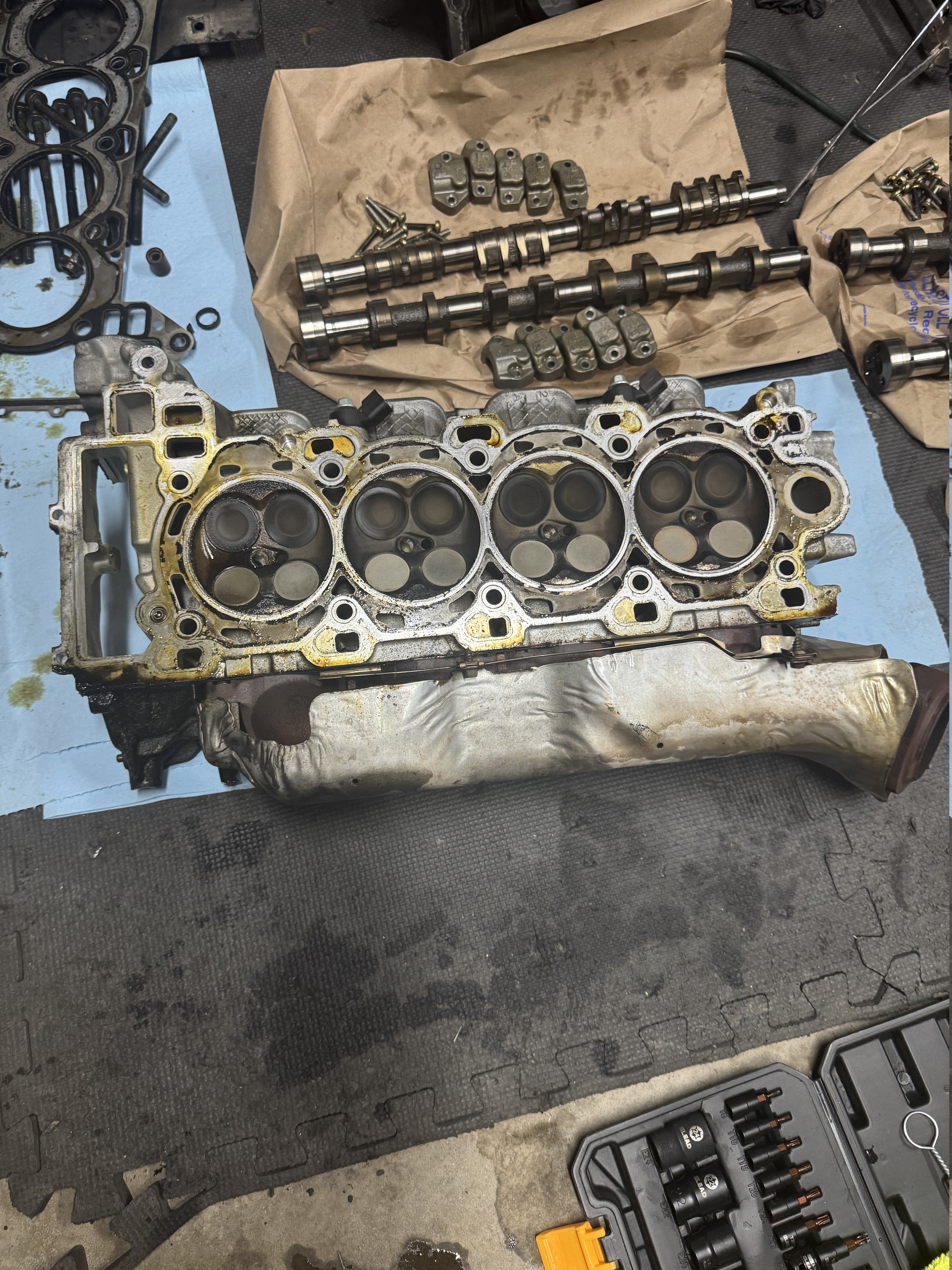

Shes sitting at 253k and I started hearing a rattle back in February and figured it was time to open her up. I found one of the aluminum guides plastic pieces had separated from the aluminum and the chain pulled it up into the valve cover and wedged it against the head. It broke a few pieces off but I was able to recover all of the pieces. Timing didn’t jump thank the lord. After pulling apart I found what look to be original, non revised guides and tensioners. Here’s what I’ve done all oem:
new timing components
oil cooler
plugs
injectors
oil restrictors
oil drain tubes
head gaskets
tappets
all new bearing cap and timing bolts

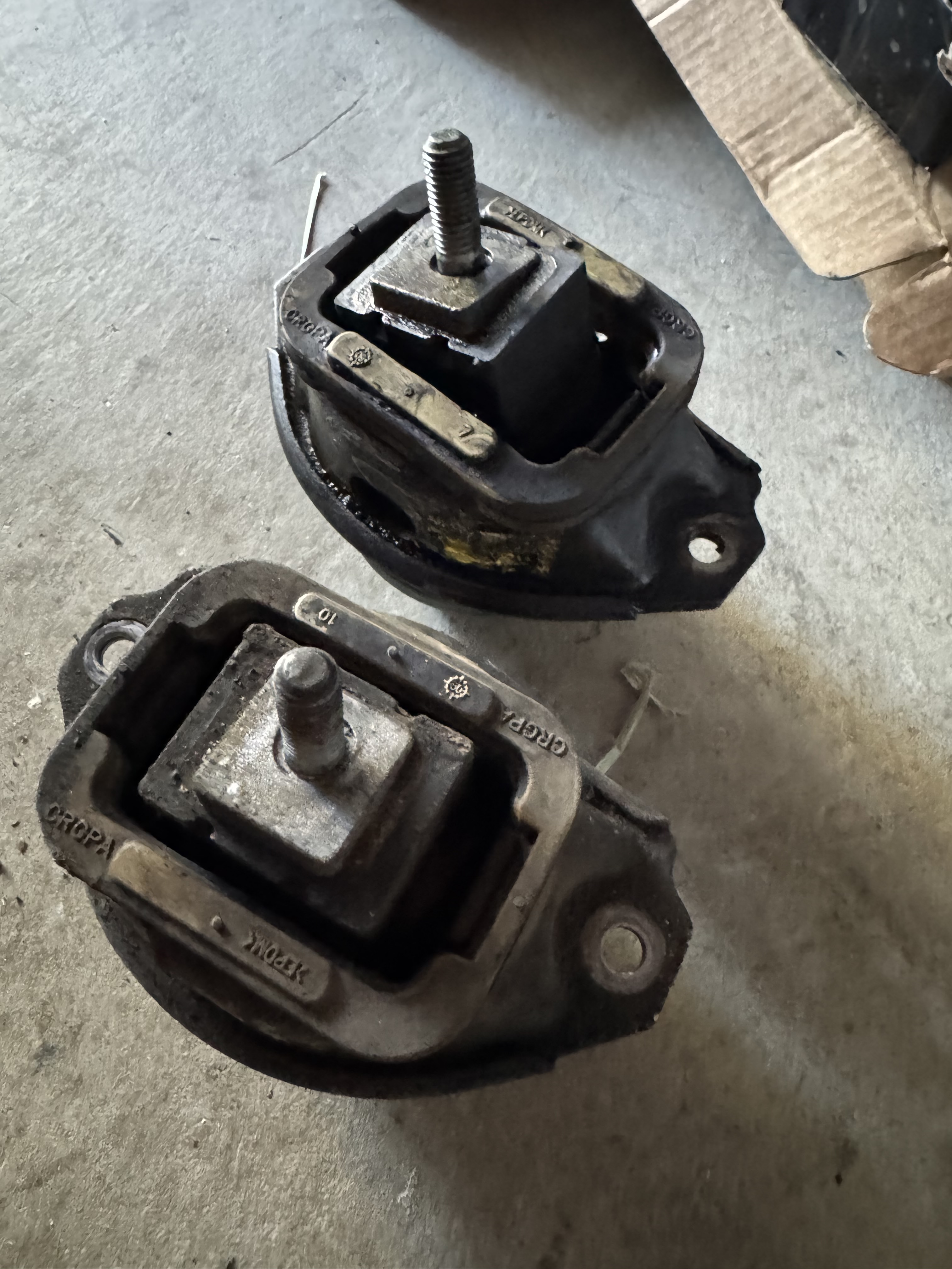

Engine mounts
Exhaust manifold gaskets and bolts
Exhaust to cat studs
Front timing cover

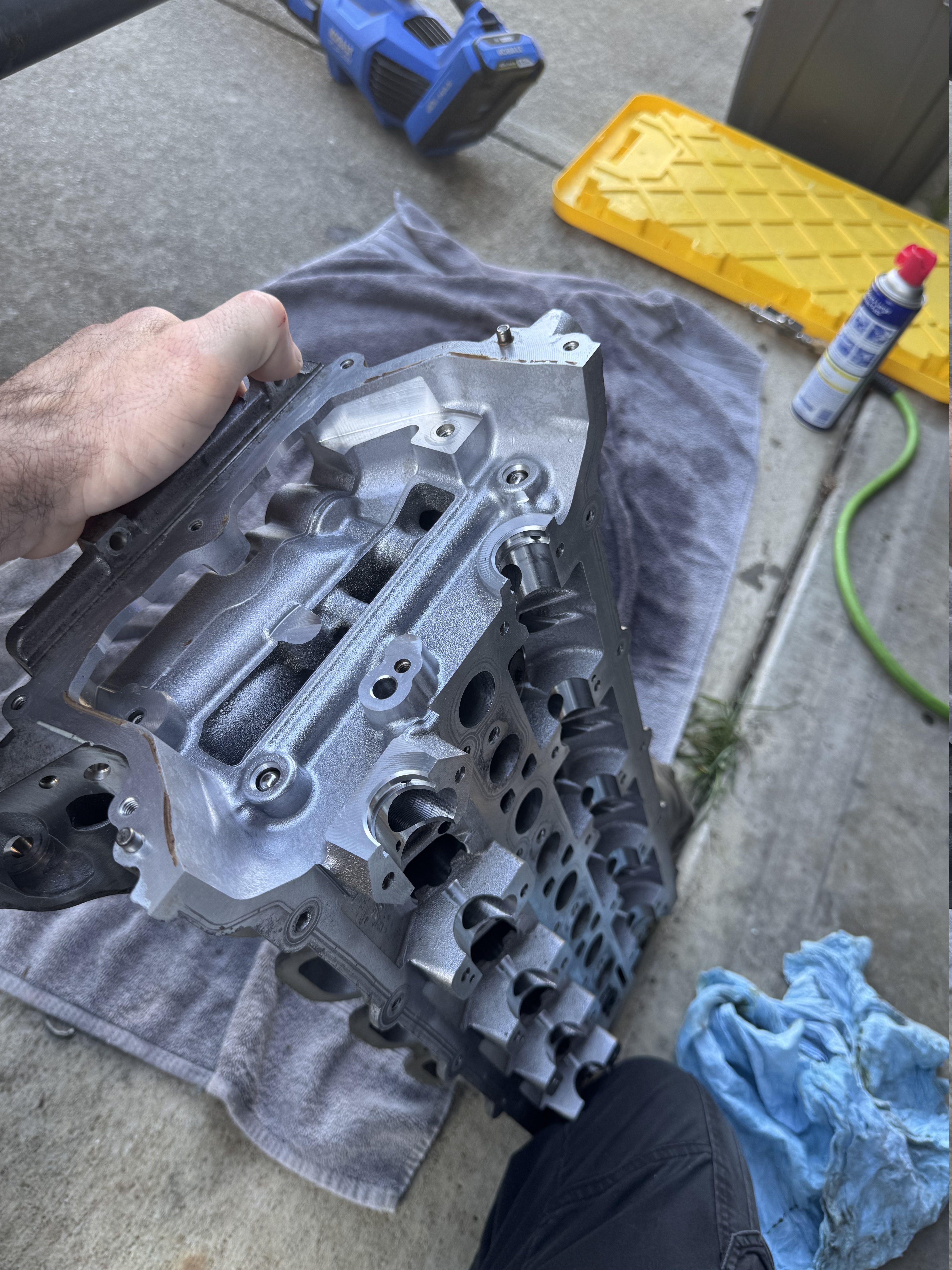

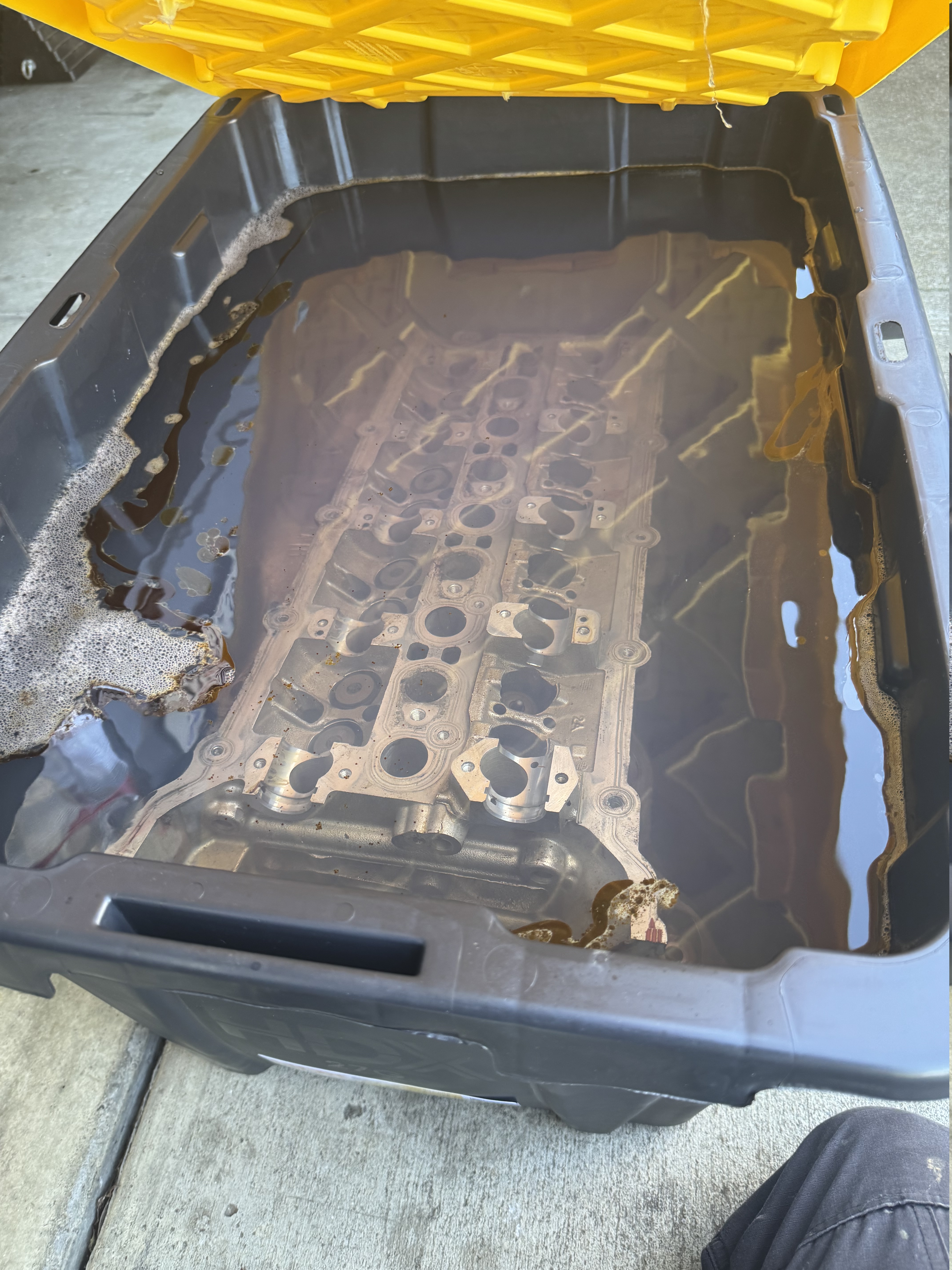

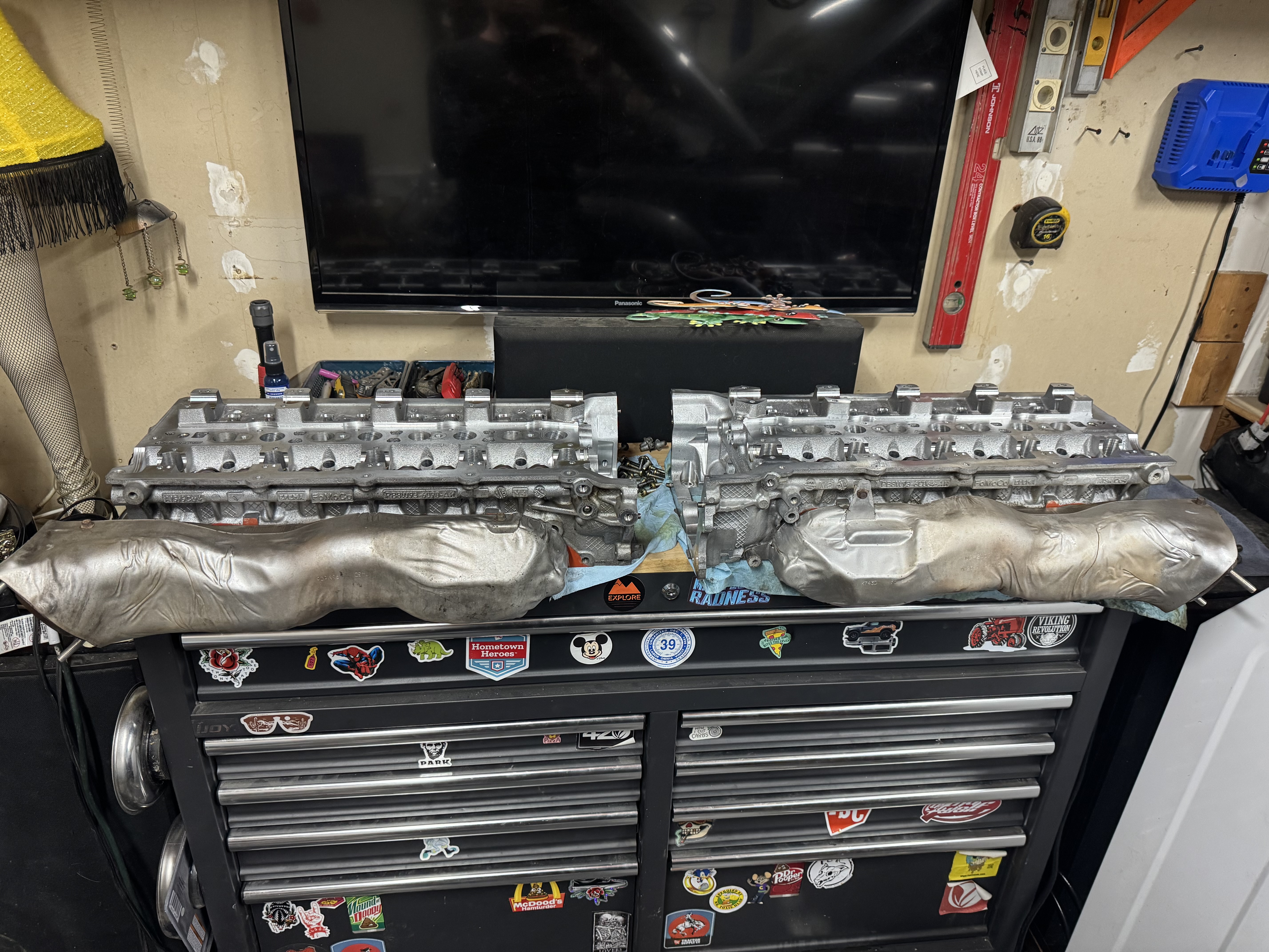

Everything went fairly smooth. I pulled the heads and soaked them for 48 hours in a purple simple clean hd solution that worked beautifully. Timing was installed utilizing the manual and lined up perfect. I’m having a few codes after startup and she’s running a bit rough.
