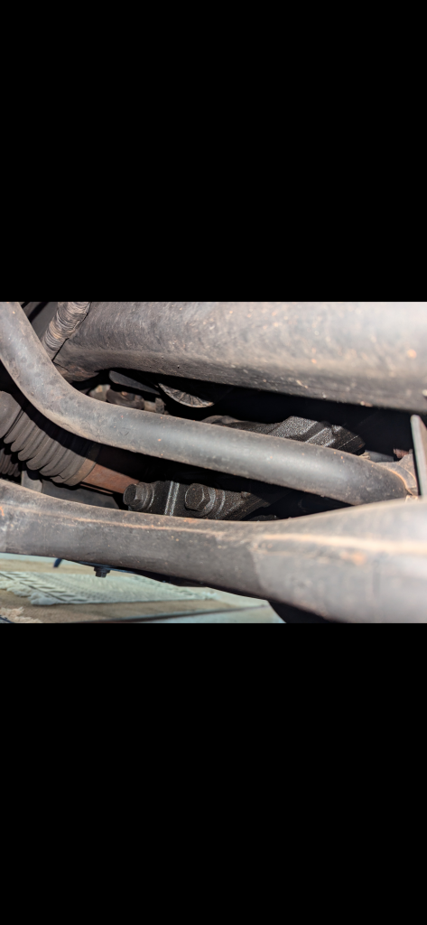

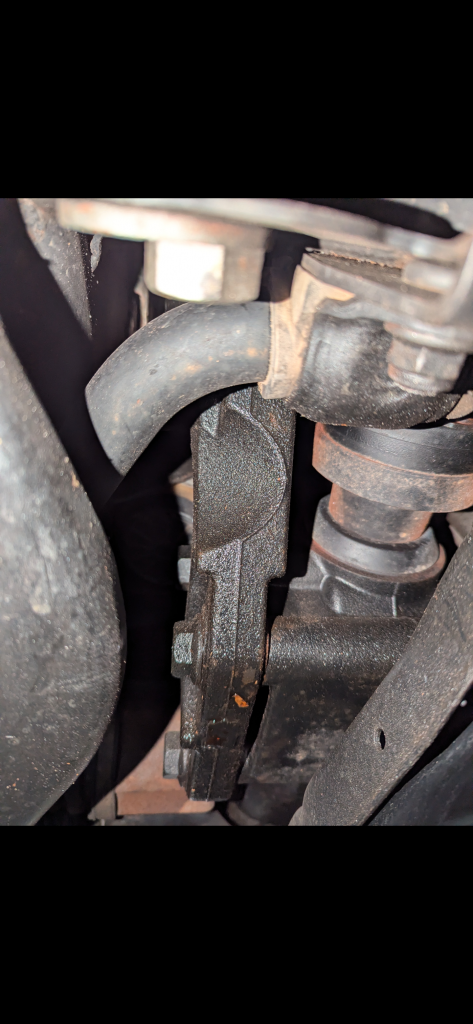

I had some oil accumulation on that same spot when I had a valve cover leaking on the driver side. Could just be residual from before you had work done. I’d blast it with brake clean and see if it comes back. My guess is no it won’t
