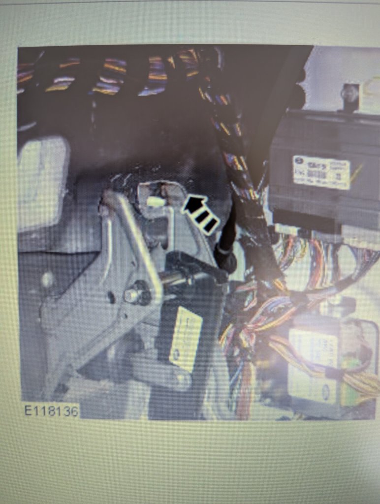

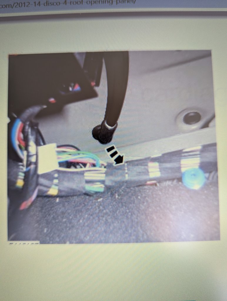

Educating myself in sunroof front drain tubes layout and from the service manual I see these two pic for driver/pass side. If I follow the other steps in the manual, it appears that taking off the inside A pillar cover exposes the tube and its connection to the actual sunroof front drain. And after some lower panel removal, the rubber elbows in these 2 pix are exposed.

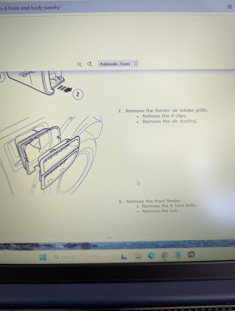

I plan to first test and clean mine before possibly doing any of the above but wanted to understand the big picture. Lots of LR3 YT videos on drain fixes but few for LR4. On LR3, that rubber elbow going through the body sheetmetal seems to dump right behind the outside silver air intake grill. Is that the same for LR4? And do these grills just pry/pop off. They are functional with tubes, so wasn't sure. Searching for those details in manual
