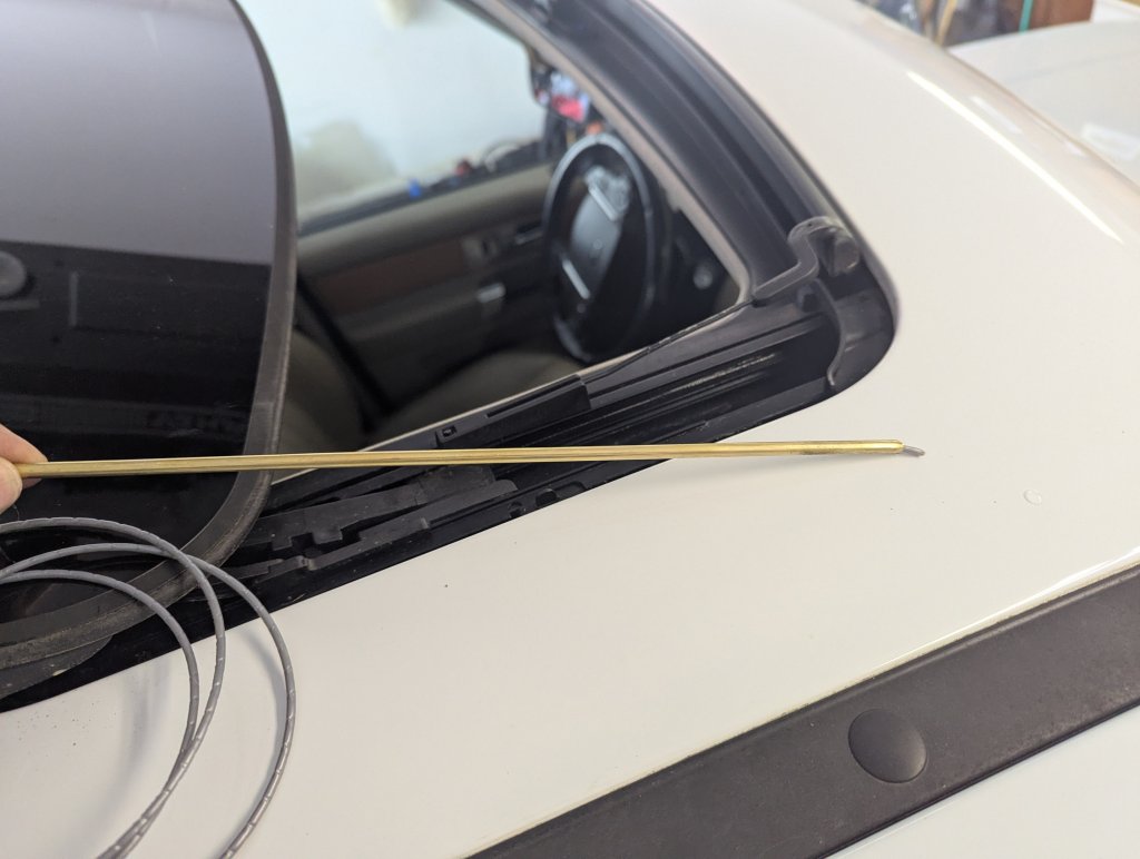

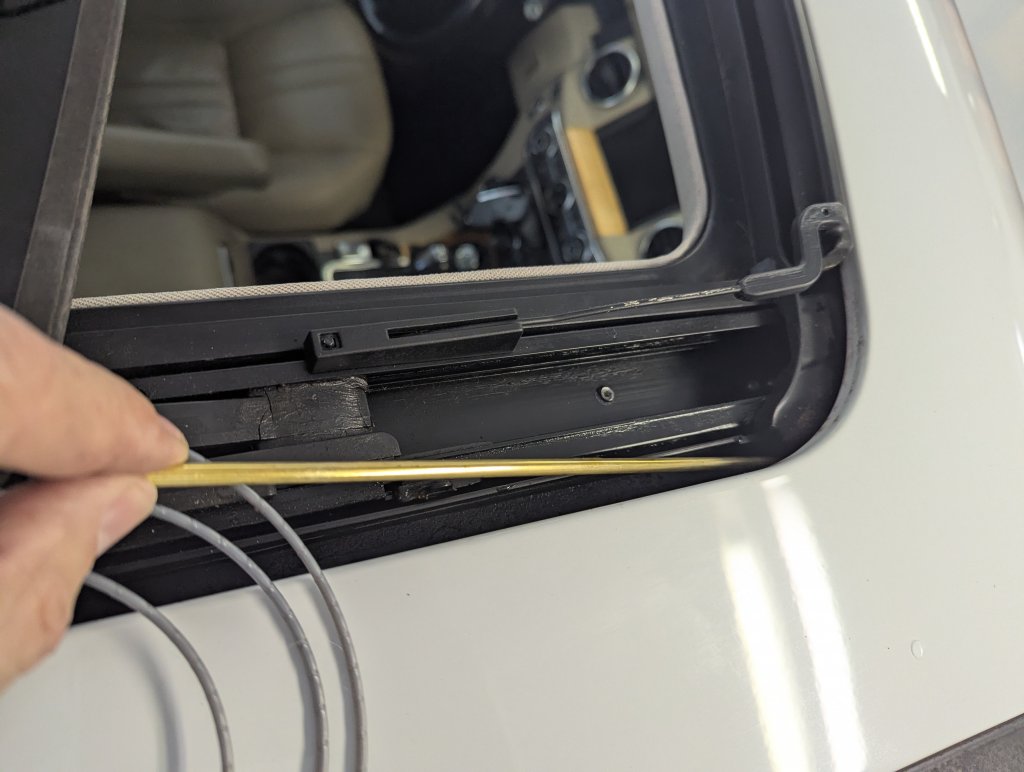

So decided to tackle it today. One trick that worked for me was to put trimmer wire through a thin brass rod and then it was very easy to get trimmer string into drain hole.
Pushed it through as far as it would go and even slowly backed it out with a drill. Still clogged.

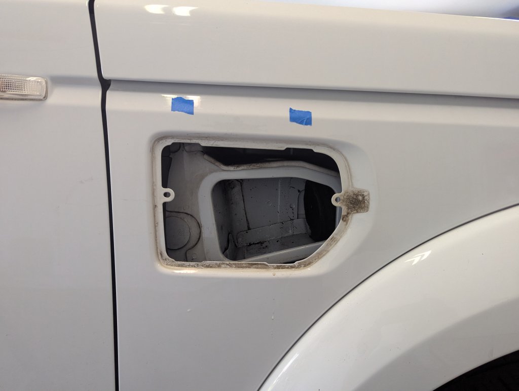

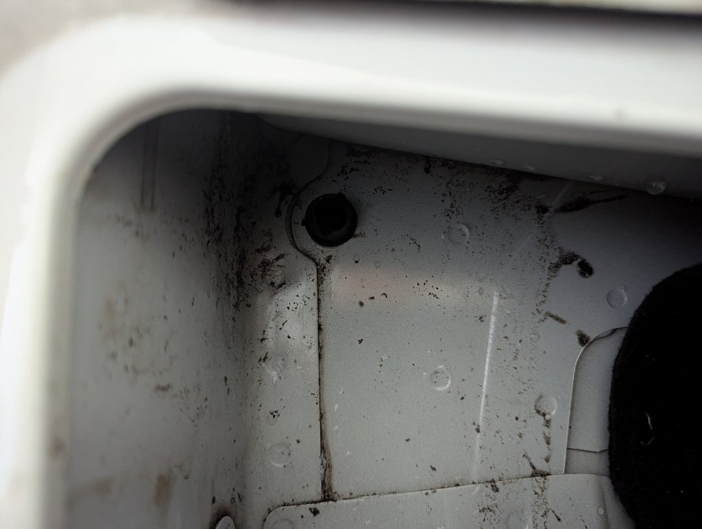

Then decided to pull air intake vent cover and once I got this off, I fed trimmer wire into ****** and moved it in/out up/ down and success!..water started draining. Ran a couple cups of hot water through after.

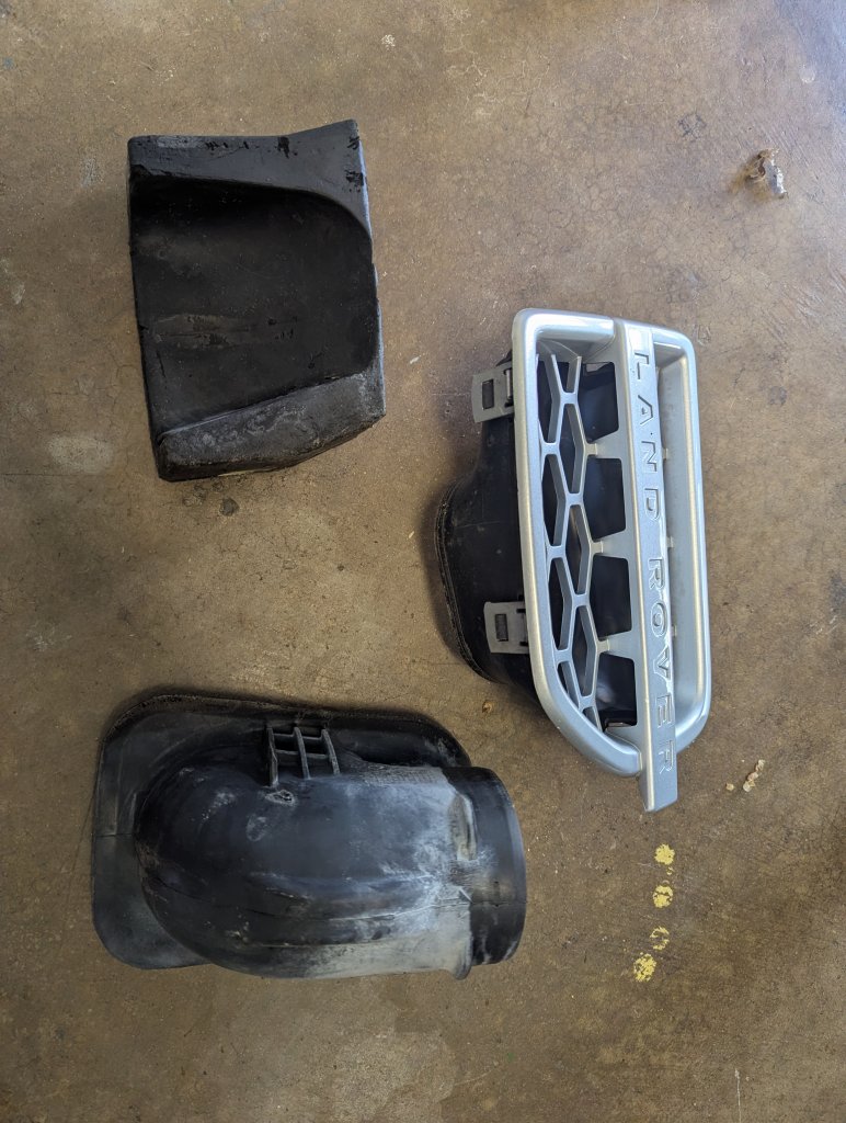

Now back to that bloody air intake cover. Almost gave up but used an old credit card (it will get trashed!) to push down on the top right clip. Once you get one to pop, then get other top and two lower clips. All good, silver cover out...
Then you pull the rubber intake duct behind the cover out, but it is stapled to a tubular felt tube. Just pull it out. Behind that is a rubber piece that needs to also get yanked.
Once all out I pushed trimmer cable into ****** at top left and jiggled and push/pulled till...success..water flowed out. Did a few more wiggle/jiggle wire runs and then put it all back together!
