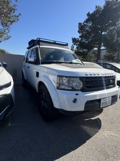

Hi Rover Community,
I am currently in the process of purchasing my first used Land Rover 2012 LR4 HSE w/ 118,000 miles on it from CarMax Wholesale Auction for $5,700.
This vehicle will be used for adventures for my toddler and growing family.
I totally understand this model has its common issues (timing chain, coolant pipes, etc) and it will always be a risk.
I did pull the Carfax with no accidents & 2 owners.
We had a mechanic take a listen to the engine and do a quick inspection and he found no concerning sounds/chain slack.
We checked the undercarriage and seems dry w/o scratches to the skid plate.
My concern is "What seems to be the common timing chain and coolant pipe lifetime?"
I have reached out to some Landrover specialists and they seem they do not want to touch the timing chain or feel it's not worth their time.
My goal is to eventually make those replacements but what are the experiences of the community with their original parts?
I would love any thoughts, advice, or concerns about this LR4 purchase.
Btw, the vehicle is located in Pasadena, CA.
