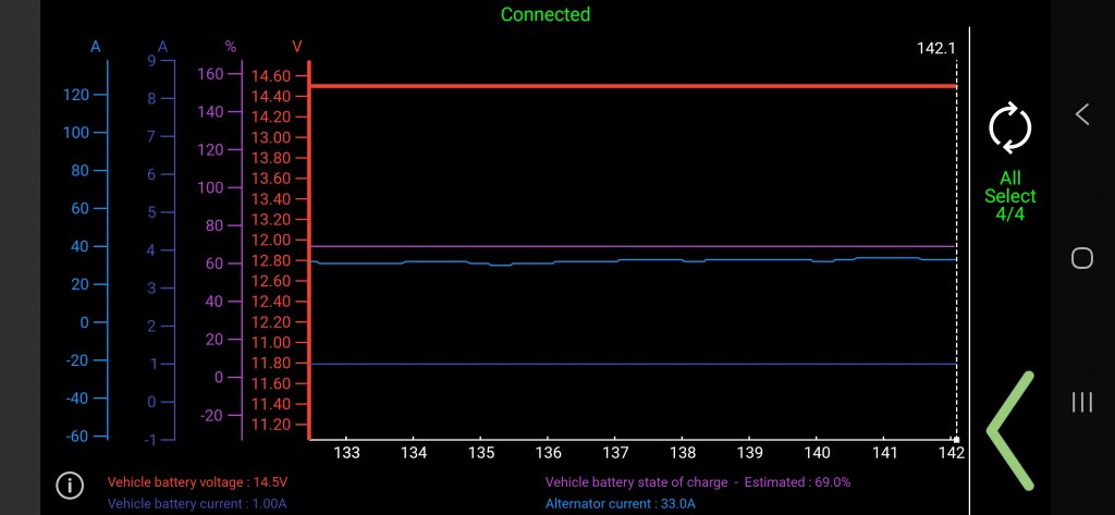

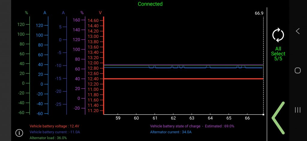

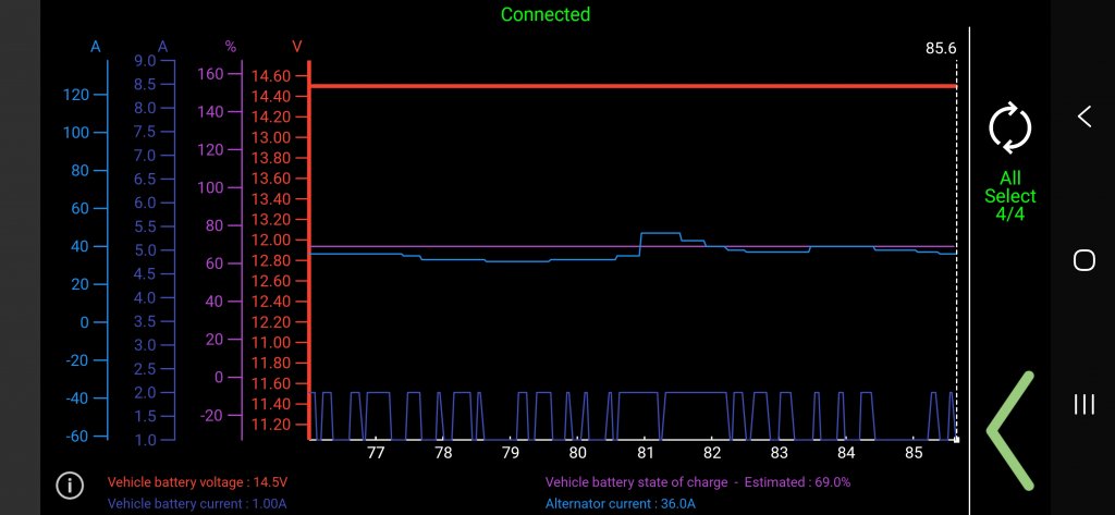

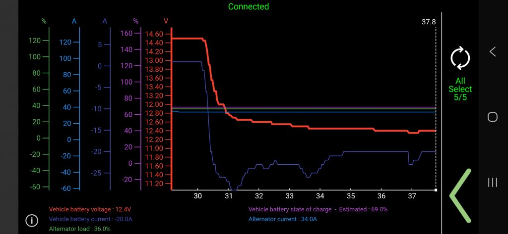

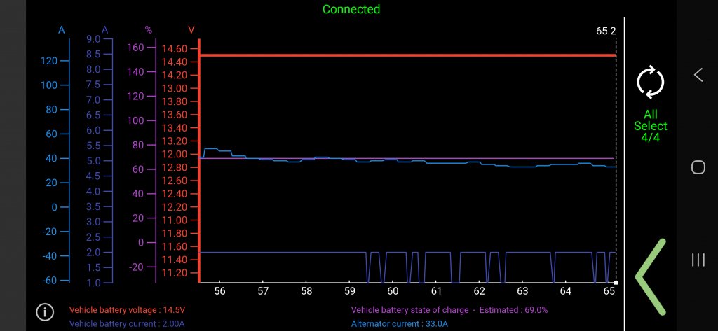

While I am waiting on the parts store to open I took a drive, the LR4 starts every time but I think that's due to the reserve built into the battery. That said, the battery voltage before starting was 12.3v and at start it drops to 11.1v then straight to 14.5v. I then made it about 1 minute down the road before the warnings pop on and all the displays shut off (LR4 stays on and drives fine), I am also seeing a service vehicle message pop up for a split second just before everything shuts off. So I decided to record what I thought was relevant as I was driving. I see nothing really change during the drive, even when everything shuts down BUT I did see a flutter between 1 and 2 amps for vehicle battery current for a short time. Battery voltage was 14.5v the entire drive whether or not everything shut down. The last two are at the moment I shut it off and just after shutting it off.

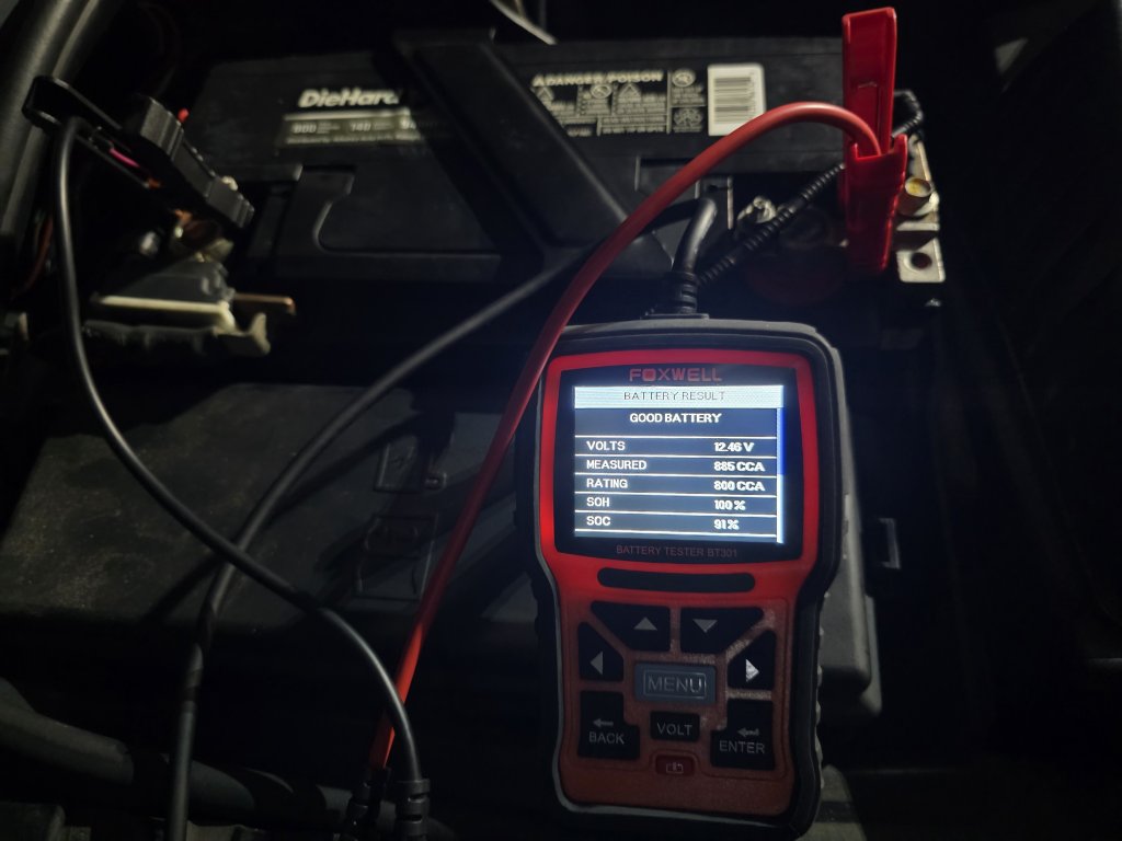

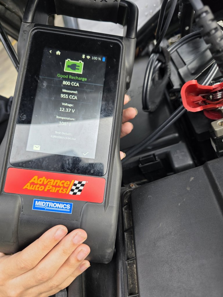

Got back from Advance Auto, they refuse to swap the battery as it tested good on their midtronic tester. Noting that both my foxwell and their midtronic is in agreement. The voltage is still less than 12.6 in both cases. Right after I had it tested I went to leave and start the LR4 and it wouldn't recognize the key FOB even when placed on the three grooves. I went back under the hood and removed and reseated the terminals just in case, which did not help, I remembered I had my jumper in the back so I grabbed that, turned it on and the LR4 started right up. any chance it could be alternator? If so is there a way to test with the GAP IID tool? I tested the alternator with the foxwell tester and it says good.

I would have gone back in and had them test the battery after the failed start. It might read fine right after you stopped driving because the alternator was charging it. If the jump pack helped, that points the battery not having had enough charge as the alternator isn't doing anything yet.

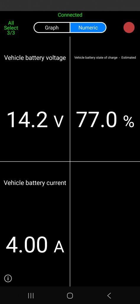

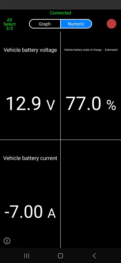

OK, so I got them to replace the battery, this time with an AGM with an October 2025 manufacture date. It would not start without the jump box off the shelf but the voltage was at 12.4 and the IID tool read it as 70% charged. I jumped it to start the LR4 and sat with it running in the parking lot for 15 min. I then was able to verify the battery amp/hr and CCA matched and run the new battery routine successfully (it failed the first time I tried right after install) I then drove around for a full 40 min then went home. Now when driving the voltage is 14.2v instead of 14.5v with the original 2.5mo old battery (thought it was 1 month old). About 28 min into the drive the displays shut off and returned a minute or so later as did all the faults. I finished the drive and the battery when I got home is at 12.9v and 76% charged per IID tool with the vehicle off. In the driveway BEFORE shutting the LR4 off it again lost all displays and came back with less codes but still a lot of Medium canbus related codes. I am going to pull out my charger, set it to AGM and make sure it gets to 100%. Any ideas on what it can be since this is a 100% new AGM battery?

-looking at your graphs, one thing sticks out to me, and that’s the fact that you only have 1 amp of current going into the battery? With a charge state of 69% I would expect the amperage to be between 5-10amps at a minimum. Full disclosure, I’ve never actually looked at that while the engine’s been running, so please take that for what it is, an observation.

Oh and the graphs were from the 2.5 month old battery that I am pretty sure got sulfanation as it would never go above 12.4V, turns out the installer at advance auto did not tighten either terminal well, both were loose
