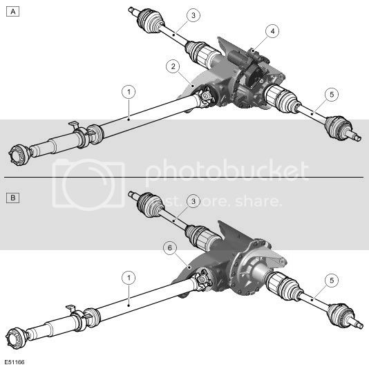

Not true. There are some V8 SE's with the Heavy duty package (full size spare and locking rear diff). Not sure which years. The only way to tell for sure is to look or have the dealer run you vin#. Many previous owners add a full size spare and this in no longer a good indicator, unless you are the original owner.
A: Lockers B: No lockers

I think you are off a bit, it is not standard on the HSE in 07 but an option. I know several 07 HSE that don't have it and people that looked to get a used 07 with it and had trouble finding one.
It is an option on any HSE or SE models, all years and is called the heavy duty package.
So it is not a difference between the 06 an 07 HSE since both can have it as an option.
